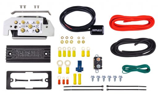

  • Derale PWM Powerpack dual fan kit w/ shroud and controller - some more on this later

This is the fan setup:
The controller is a nice piece with soft-starting and variable speeds based on demand. It also has an over-ride option and of course an AC-trigger. I went round and round about going this route vs. maybe sending the bad radiator down to LRS to have him custom fab a shroud or something, but ultimately went for simplicity.
The core of the radiator is 23-3/4 x 21-15/16 while the fan shroud is 22 1/2 x 19. So, yes I'll end up with just over 1" of uncovered core width, and nearly 3" of uncovered core height. That's not ideal, I know. Still, the large majority of the radiator will be covered and these fans pull 3750 CFM (which about the same as the vaunted Taurus e-fans) so I really think it'll be fine. Also, I got a 180* t-stat. There is a lot of debate about t-stats on the Jeep forums, people talk about running the engine "too cold." However, I looked into the PCM the WJ uses, and it actually uses the pre-cat o2s to determine open/closed loop. It starts going closed loop once it's getting a valid reading. By all accounts that's way before 180 degrees, and there is nothing in the PCM that would cause it to stay in open-loop, cold-start-enrichment anywhere remotely close to 180.
To be clear: I know a cooler t-stat will not cure overheating issues. However, we've never actually had any problem with overheating with this WJ (or the Blue one for that matter). However, the factory 195 degree t-stat and the logic used to control the solenoid on the hydraulic cooling system tends to make these jeeps run 210-215 at all times. That's really not too bad, and nearly all newer vehicles run like that. Of course, the 4.7 is spe-shul and heat is the number one cause of them dropping a valve seat. My intent w/ the 180 t-stat and the e-fans is to try to keep the operating range more like 180-195, as opposed to trying to fix some sort of overheating issue.
Anyway, I am curious as to everybody's thoughts on whether or not having the shroud slightly under-sized is going to present problems. I could still cancel that order, or keep the fans and controller and have LRS fab up a new shroud. I really think it'll be fine... but would like to hear what y'all think.
-TJ
No, the smaller shroud will not hurt in itself. The important thing is to get the shroud to mate with the radiator core, with no gaps. You want all the airflow to pull through the core. Rubber gasket material , even door seal, works like a champ on the edges of the shroud. You will loose out the little bit of exposed radiator, but a sealed shroud will cool excellent if the radiator surface it is pulling through is enough.
How challenging that will be I don't know, I have not torn mine apart for my cooling mod. But will be soon, I need it done before White Rim Road and Moab in April. I have most parts, but still need the fan controller, power steering pump, and high pressure line.
Also something to consider- when the hydraulic fan is removed, you can install a small power steering cooler off a 99-00 and use it, and free the BIG hydraulic cooler to be used for the transmission. It's on my list of things to check out when I have my front end apart.
Also something to consider- when the hydraulic fan is removed, you can install a small power steering cooler off a 99-00 and use it, and free the BIG hydraulic cooler to be ued for the transmission. It's on my list of things to check out when I have my front end apart.
Yeah, I will for sure be using something to ensure the shroud is fully sealed against the radiator core. As you said, it's necessary to make sure air goes through, not around. Besides that, it also protects the radiator when things get to flexing and moving like they will even with the best mounts.
Hmmm, hadn't though about re-purposing the PS cooler. I think I'll have a look at it all when I get it apart and see what I really want to do.
