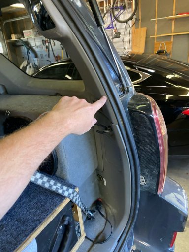

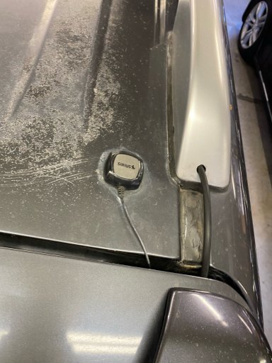

I also finally installed the SXM module to my Sony receiver. Once again, I did not take pics but I will include the pictures from my buddy with a 4th Gen who has the same module
Basically, you run the antenna cable behind the glovebox, down the kick panel, and then under the plastic sill panels that run down the length of the the vehicle. When you get to the rear, you can just tuck the cable in between the carpet and the plastic storage/wheelwell things. You can then run the cable behind the weather strip, up onto the roof
