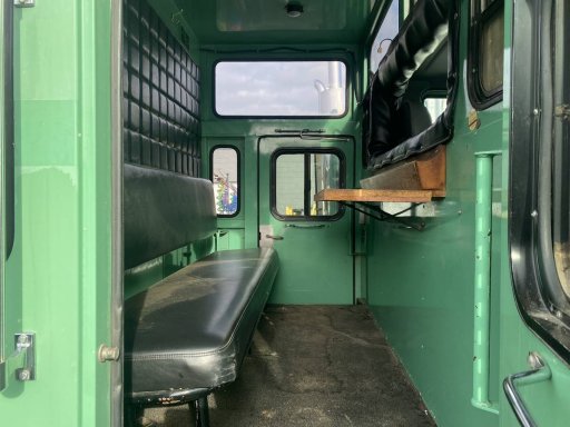

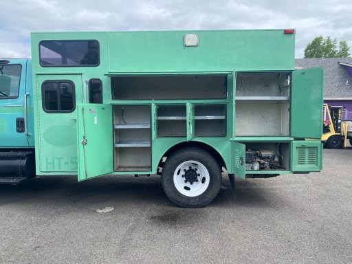

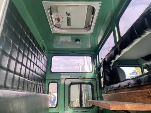

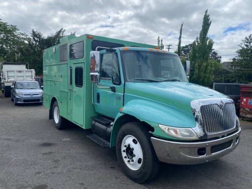

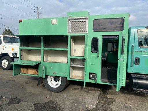

I've been eyeing this vehicle for a while now when it pops up on Craigslist from time to time. I'm sure you guys see the same potential I do, my wife thinks I'm crazy. Pros/Cons, Talk me out of it!
Cabin area behind the main cab would be driving seats for the kids then convert to bunk beds for sleeping. Kitchen, shower/bathroom, storage would all be accessed from the outside in the storage compartments. Might even put a rooftop tent and "deck" on top for the fun of it.

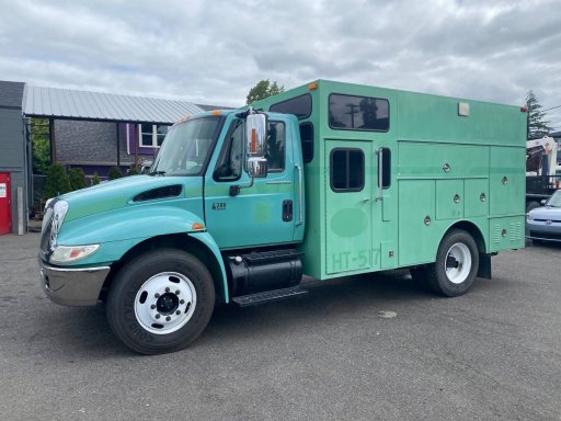

As I am sure you are aware already this is a forest service hotshot crew buggy or a crew transport for fires. They see a lot of miles and harsh conditions. I didn't see it in the pictures but some of these are only 2wd. I am sure it has many miles on it as well as these criss-cross the country all season. I have a wildland engine the same year and model as the chassis and it has been fairly reliable. They are heavy and slow if you are looking to put long miles on it. Running around in the fire district they do fine. They are notorious for diesel leaks, bad mileage, sometimes issues with 4wd and electrical gremlins. Overall if it is a good price might be a good consideration. You will have maintenance and it is spendy if you don't do it yourself. You will regret it at the fuel pump or the tire shop. It would make a good platform just go into it knowing what you are getting into.

Yep, That's California forestry green for sure. 110,287 miles, 3378 engine hours so not a huge amount, even if they were rough miles. Its is only 2wd though. Price is $25k
