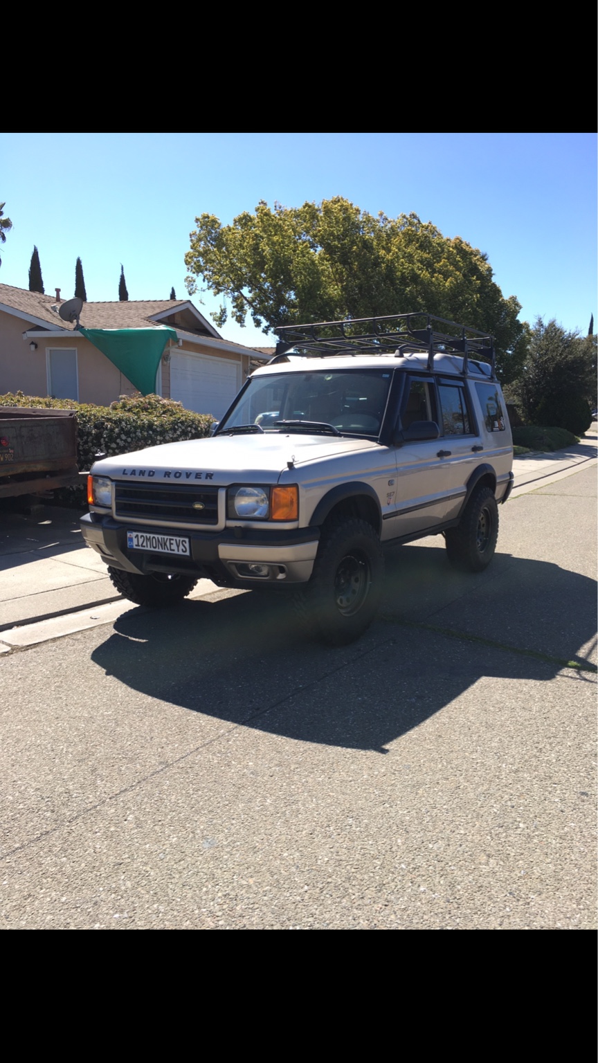

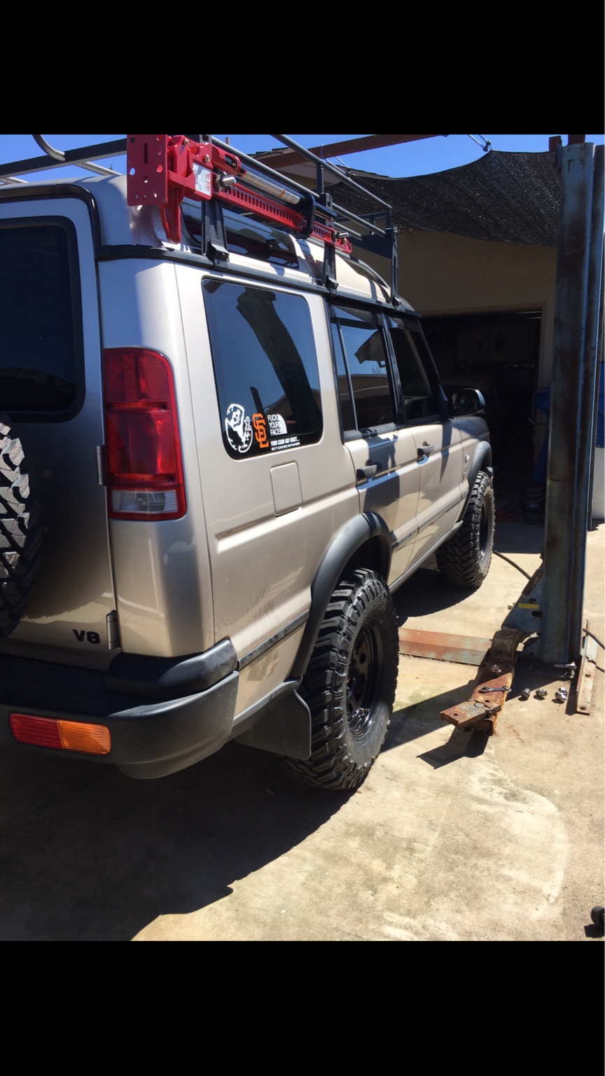

I attached the shocks then bracket for the springs ( spring photo not taken)

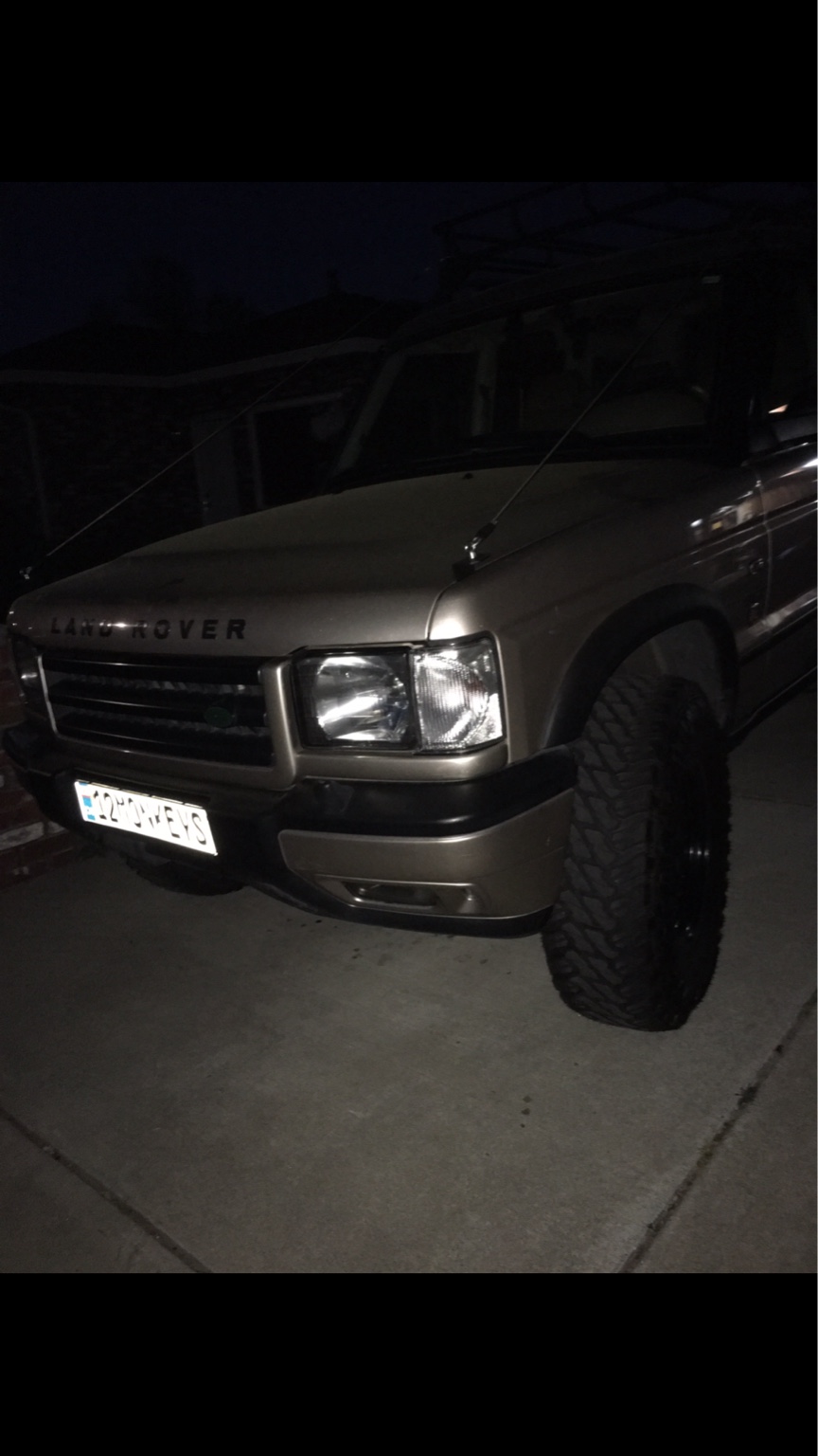

And there she is sitting on some 33" tires with a 3" lift.

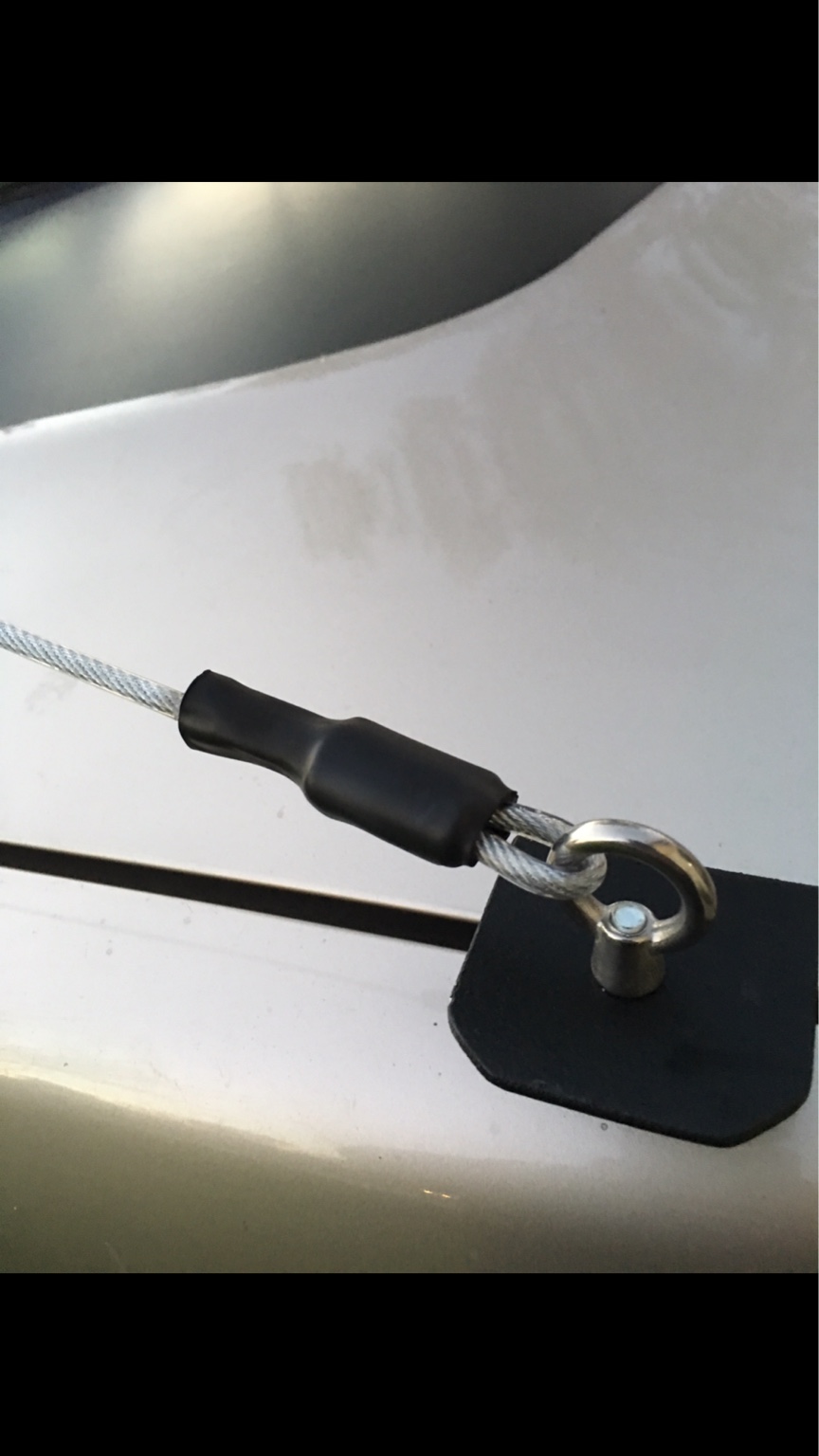

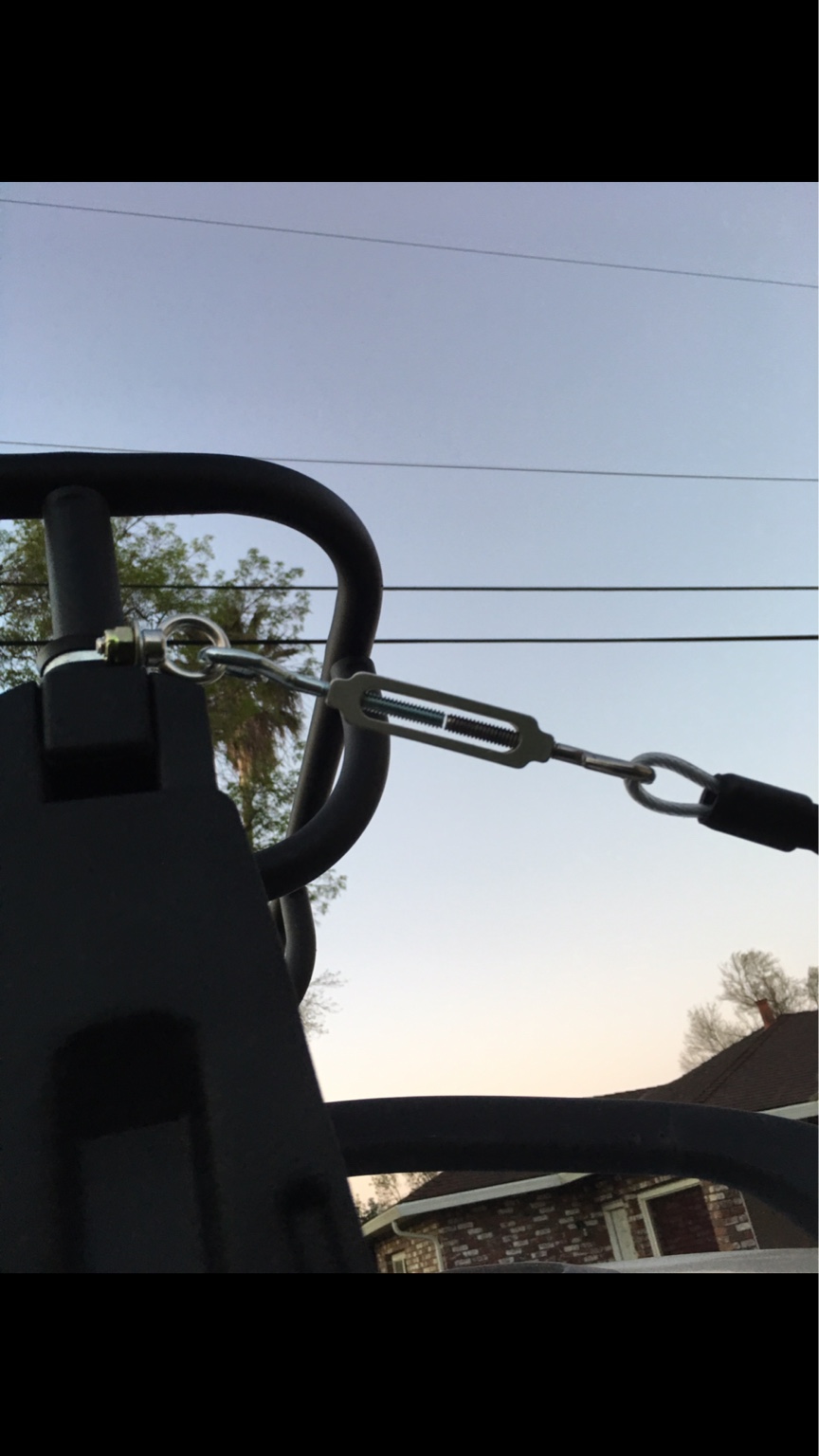

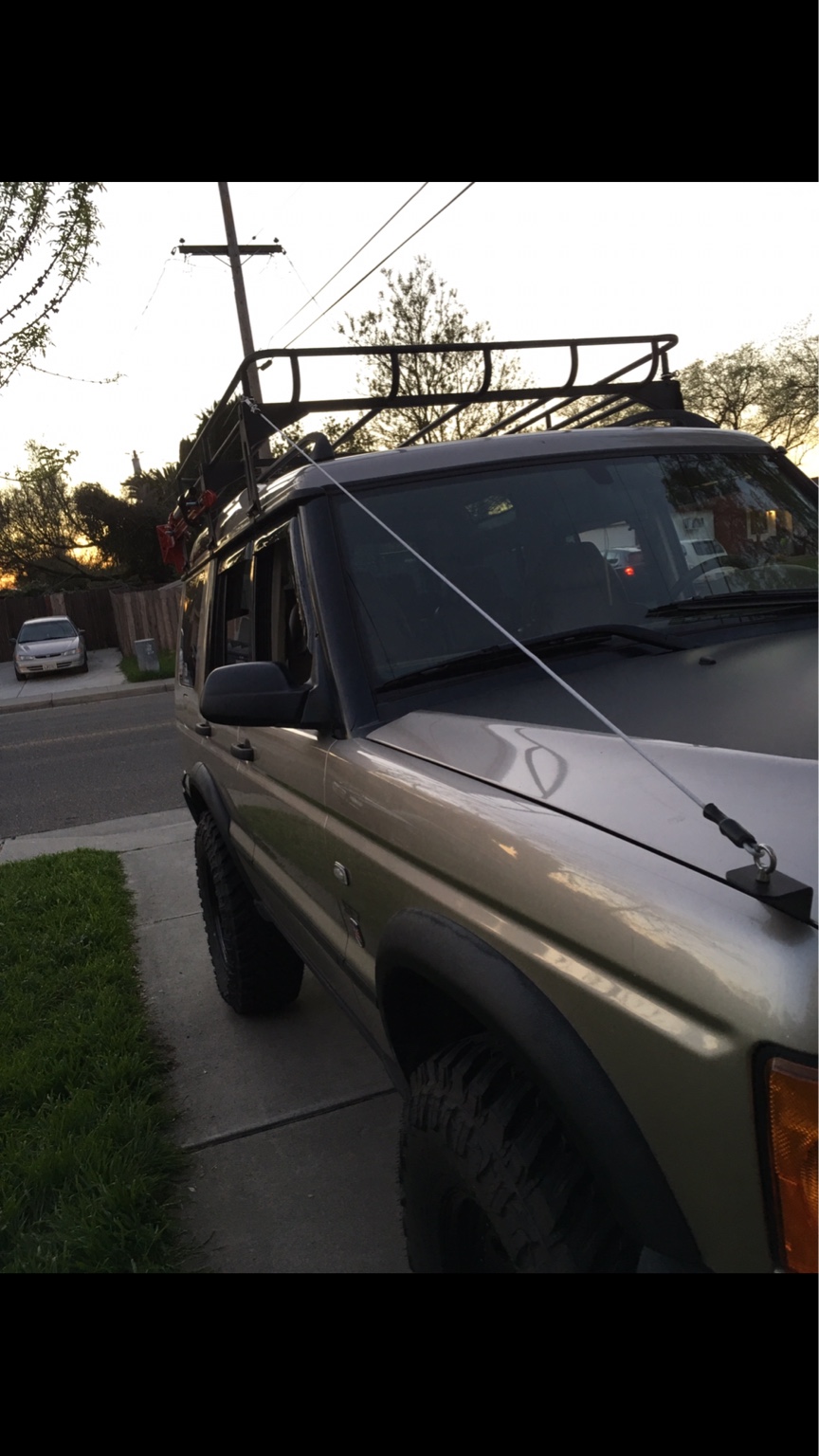

Then after that I installed the limb risers cable since I was done with the engine compartment and didn't want them to be in the way, I got some clear coated cable and some clamps along with some small cable tensioners from Ace hardware along with heat shrink to cover the clamps

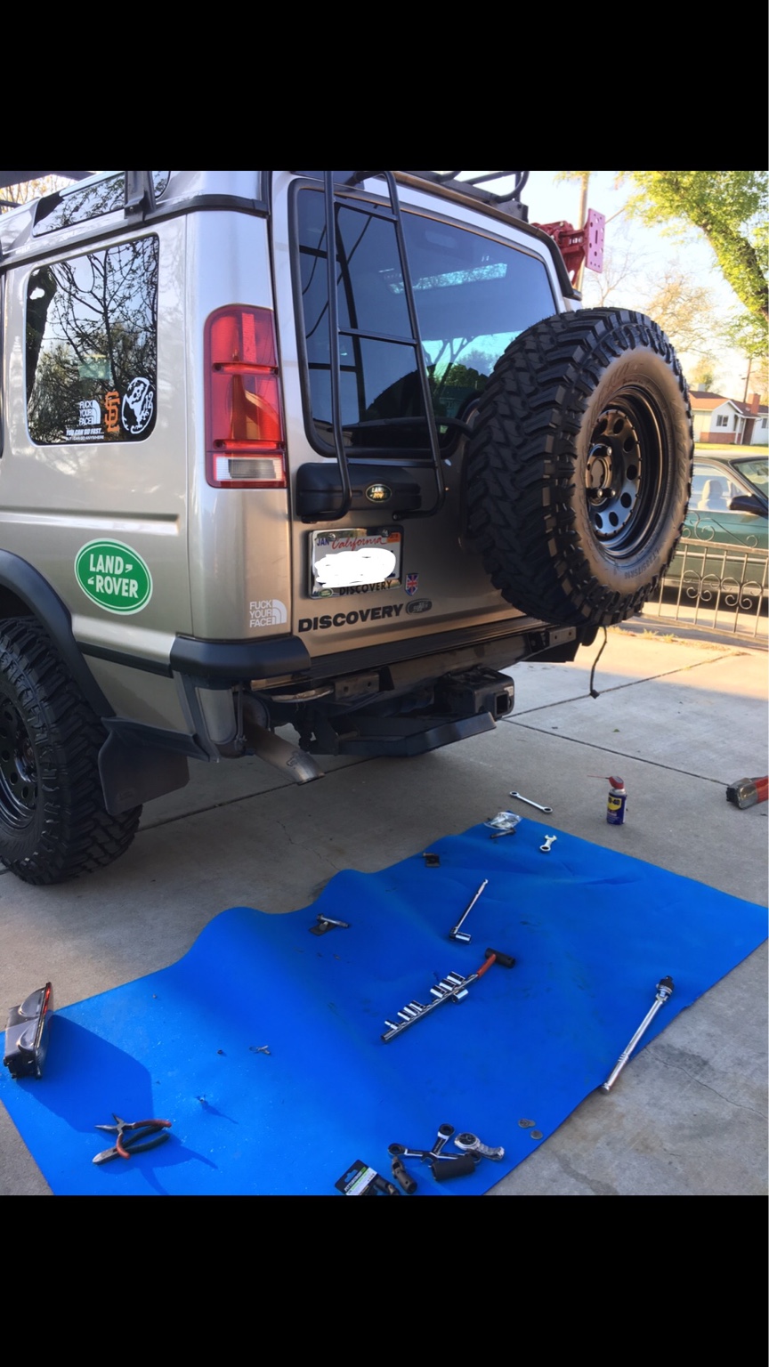

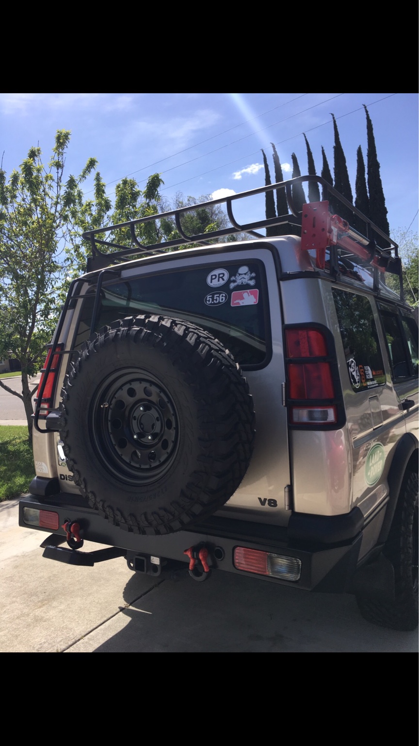

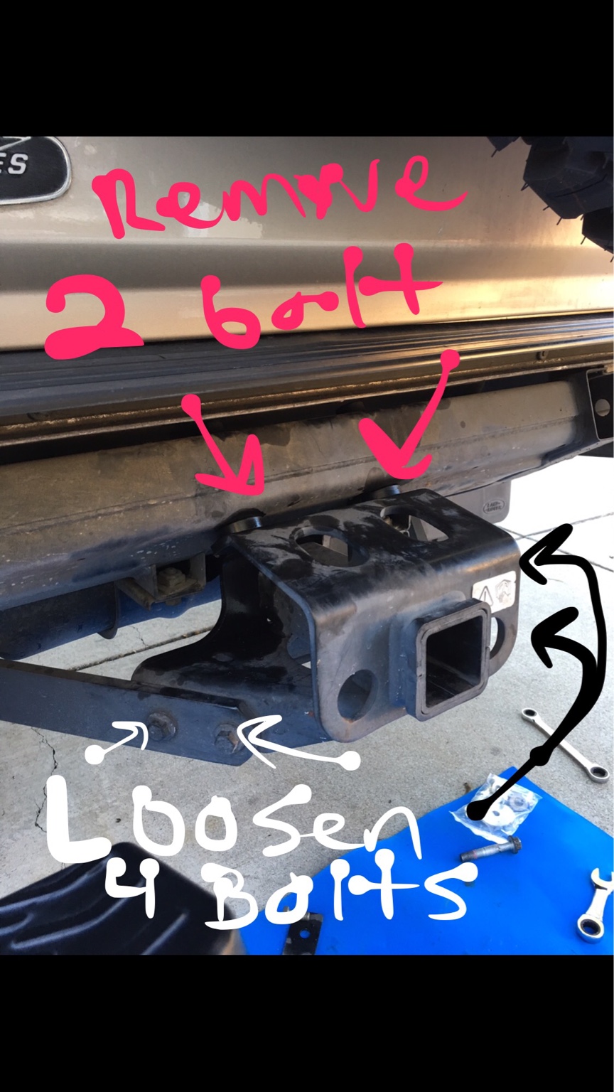

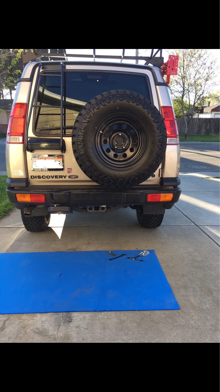

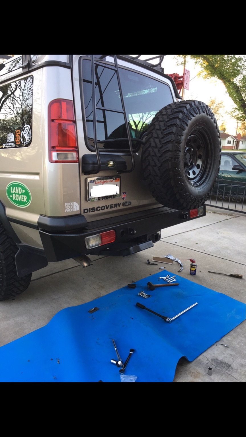

Rear steel heavy duty bumper came in from lucky8 and the old one was easy to remove after spraying it down with some WD40, (trust me it was needed) I believe it was either 2 or 4 bolts to remove, then I removed the 2 bolts from the hitch to frame and then I loosened the 4 on the sides in order to give it some play.
It was ok doing it by myself but if you have help take it. The new bumper has a bracket that slides in between the hitch and the frame and then bolts into the stock holes.

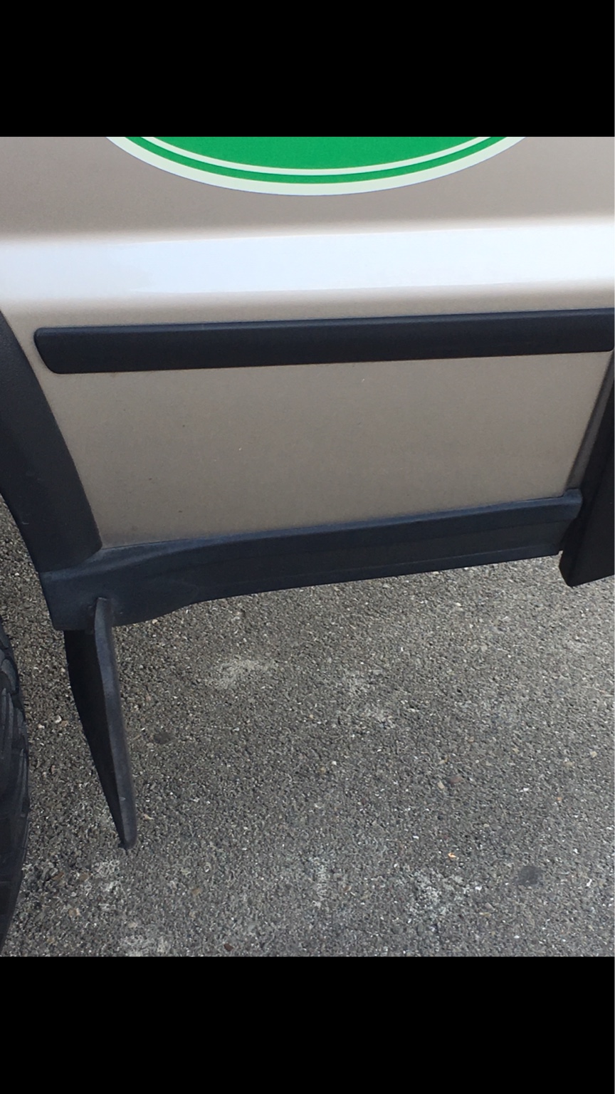

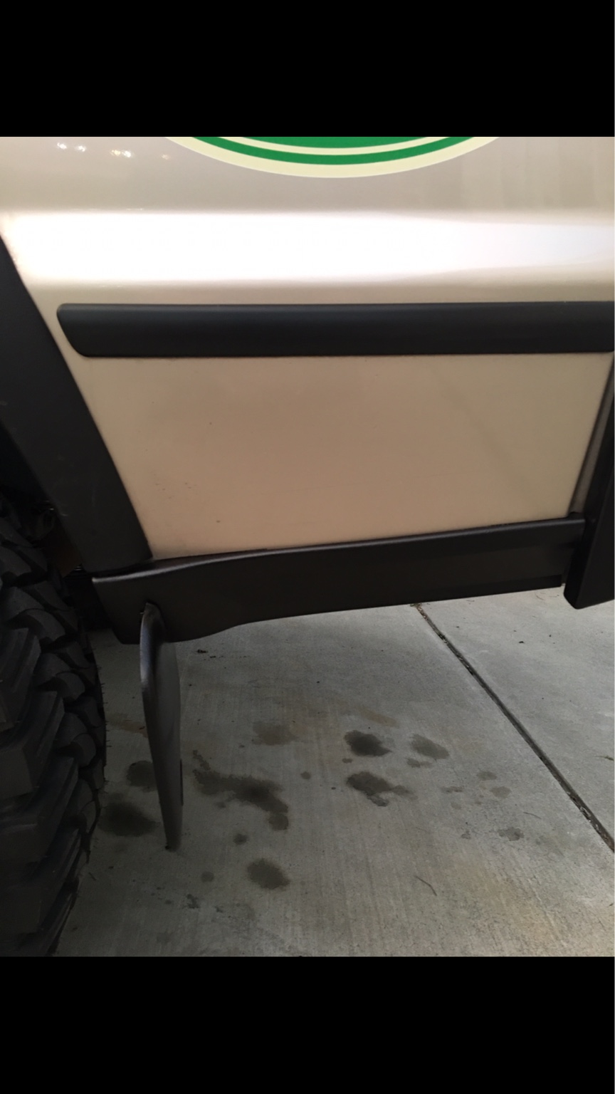

With the tires and rear bumper on the made the trim look dull so I blasted the trim and fenders with truck bed liner (TBL) from O'reilly auto parts

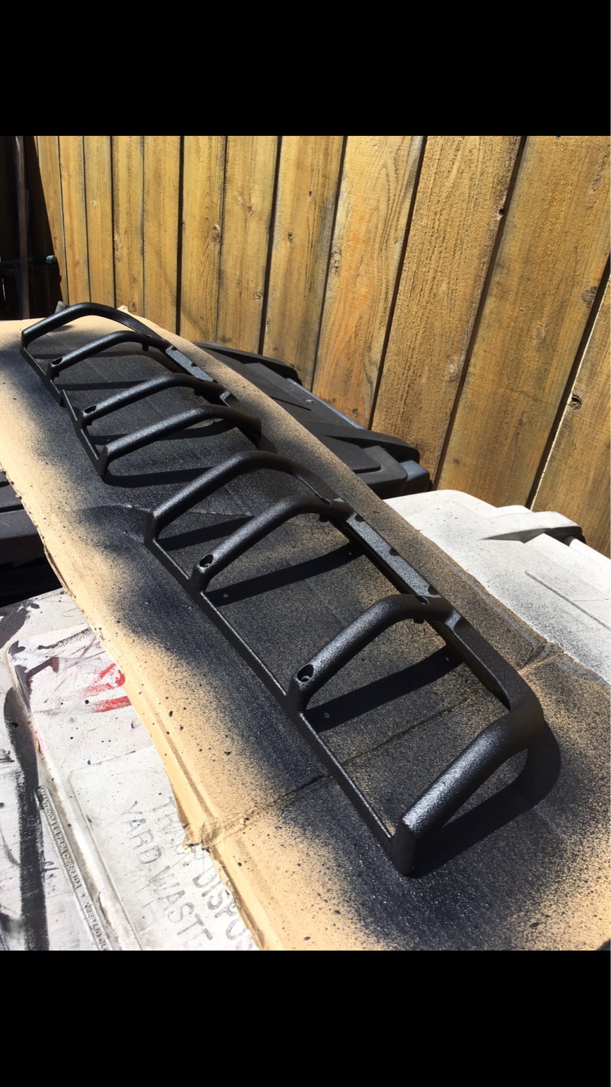

While I waited for the front bumper to come (back ordered) I dressed it up with front and rear clear lenses, rear D-rings shackles and taillight guards (just for looks actually) sprayed with TBL, and added a new shock for the sway bar.
