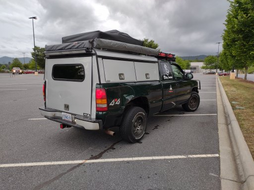

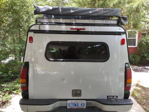

So, got a little progress done over the last few days. Got the topper adjusted and permanently mounted to the bed of the truck. I swapped out the halogen taillight bulbs with new LED bulbs since I will not be able to access the screws to the taillight assemblies easily, so these LED's should last for a few years. Weather proofed all the gaps, got it bolted down in 6 different locations. Got my rooftop tent attached to the top. I ran 1" superstrut channel iron on the top of the topper, attached to the cross rails on the inside frame, then attached the RTT to the superstrut. Got my 50" LED light bar installed in the back, along with the rear and side awnings. The bigger awning came will detachable walls, so when both the awnings are deployed, I can take one of the walls and run it along the rear awning and boom, instant batwing for a fraction of the cost, lol. Started raining on me, so didn't get everything done I wanted to, but will continue on Monday. The POA that I currently live does not allow any outside work on Sundays, so I guess I get a break for today, lol. Got a ton of projects coming over the next few weeks, so keep an eye out. She's getting there :)

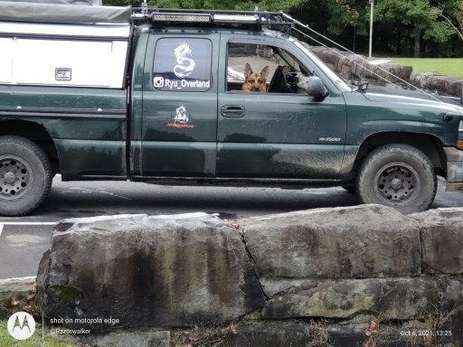

Latest picture & build update, taken just a few hours ago up on the Blue Ridge Parkway. Added all the lights (Curved 56" on front, 2 36" on the RTT rack for the sides, moved the "pods" to the rear bars for rear ditch lights and another 48" bar on the rear. Wiring is temporary. Got weather-proof Quick disconnects coming so if I want to remove the rack for hauling, I don't need to cut wires.) Yakima Roof Rails & Smittybuilt Defender Roof rack installed. Not sure if I'll keep the rails. It's the perfect height for when I add a side awning and for the solar shower, but I think would look better if it was just above the light bar. I did get a brand new Smittybuilt Universal Mounting kit with the rack, but already had the Yakima's installed and Flex sealed. Let me know what you guys think or if you've had good/bad/negative experience with a setup like that.
She's not the prettiest lady on the road, but she's been turning a lot of heads :P

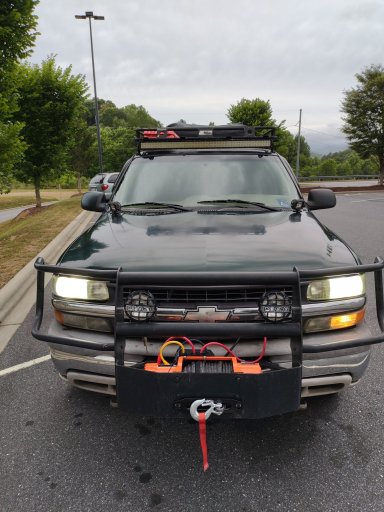

So, back with another build update. Meant to do one a few days ago, but just been really slammed.
So, first one is not a biggie, but got rid of the chrome junk hook that came with my winch and picked up a Badlands Forged Hook. Harbor Freight just opened a store in my town and had these bad boys for $20 each. Had to get one. Really want a Factor 55, but not in the budget at this time.

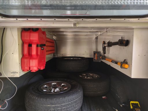

This one I'm really proud of. I've always fretted about my stuff getting stolen and trying to keep things on a budget, wasn't really wanting to spend hundreds of dollars to secure my stuff to the outside of my vehicle and honestly, there was no really good place to secure it to. So, this is the solution that I came up with and I think it will work nicely. I also just picked up those wheels and tires for $100 for all of them last night. The wheels will not work on my truck, they are for a Nissan, but the tires are Goodyear Wranglers with LOTS of good tread left on them. Definitely worth the $100. Plus, the wheels still have the factory TPS sensors in them. Figure I could probably make my money back on the wheels and sensors.
Had to make a few adjustments to the back. The way that I originally had everything, it was extremely difficult to get the back awning to open. So, relocated both the rear light bar and awning on a bigger bracket and now it all works nicely.

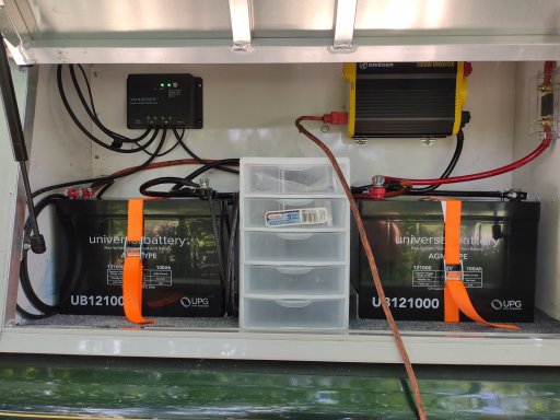

And here is my battery box. 2 100ah batteries run in parallel giving me 12v@200ah. More than enough for my needs. I know it's not the prettiest cable management, but not wanting to cut any cables just yet incase I need to relocate anything later, I won't need to buy new cables.

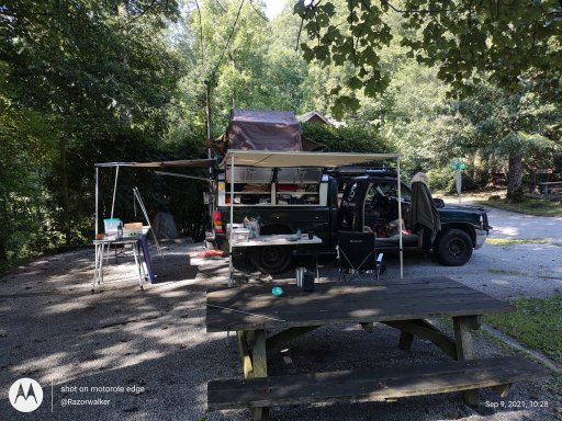

So, build is finished and have been on the Transamerica Trail for the last month. Sorry for not updating sooner, just been enjoying the journey. Search Disabled Overland on YouTube to see videos if you like. Here are some pictures of the journey from the past week....
