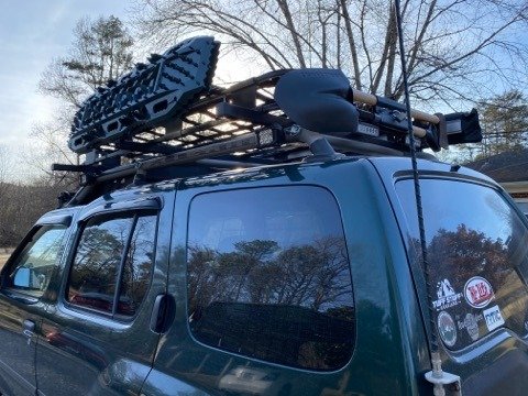

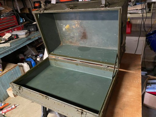

Thank you! Still have a lot of work to do! The inside cargo area has been redone twice already due to certain things I have had to haul being my daily driver. I still have the roof mounted cargo net to hold some lighter items close to the headliner. I had a grate style shelf I fabricated that was mounted right below the rear side windows and covered the entire area from the back of the seats to the hatch. I have taken that out but left the brackets. I'm in the process now of using my Grandfathers old military foot locker and turning it into a Chuck Box to store all of our base camp kitchen items. It's gonna sit up on it's side and when slid out the "Top or Lid" will open downward and be used as the cookstove top with everything we need store in the "Bottom" which will actually be the back. Hope that makes sense.
I will be removing the drivers side rear seat completely and building a floor so the chuck box will be level. By doing this it gives me storage options below the new floor that I have yet to figure out what I'm going to do there, probably some drawer storage.

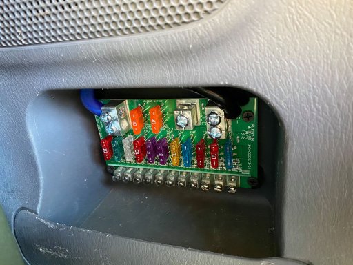

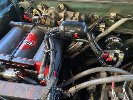

Got the dual battery setup completed, Adding aux ports throughout and did a total rewire of all the aftermarket accessories to the Optima Red Top.

Looks slick! I can't believe you managed to fit a second battery under the hood. I hadn't done the measurements, but it didn't look like there's enough room down there. I'm going to have to re-think putting mine in the cab when I get around to it.

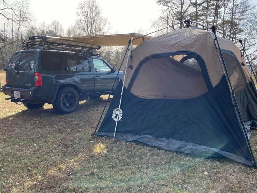

Let me know how that tuff stuff awning is. I'm certainly in the market for an awning myself (might just build something until I can get enough money to buy something that's gonna last).

Thanks man! In order to get it in there I deleted my cruise control which I never used. Relocated the horn, relay box on the inner fender and a 3 gang of plugs. Once I did that I dropped the Red Top in and off to Auto Zone I went for a battery tray and mount! Took me awhile to get it all done because I rewired the entire X to get everything xtra on the Red Too and keep the Main as it’s intended purpose....to crank! Lol. I like the Tuff Stuff awning, we are an authorized dealer for them...so far worth the investment. Now that all that’s done, My next focus is Solar / Power Station and Propane system for hot water and heat!

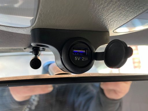

Lastest project completed! Dual battery setup, total aftermarket accessories rewired to aux battery and multiple power points and usb charging ports added throughout for planned electronics. Such as a Dash Cam, New CB radio, GMRS Radio and newer Garmin Navigation unit. I have a Nuvi now in addition to my Apple Car Play Navi but looking to add a OHV trail mapping unit.. So many plans, so little $$$ LMBO!
