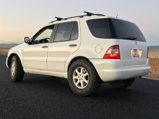

With some help from the guys at Mile High Off-road I got some Rubicon take-off BFG KO2 285/70R17s on there. We cranked the torsion bars to get a couple inches clearance in the front, and it all fits perfectly with no rubbing.

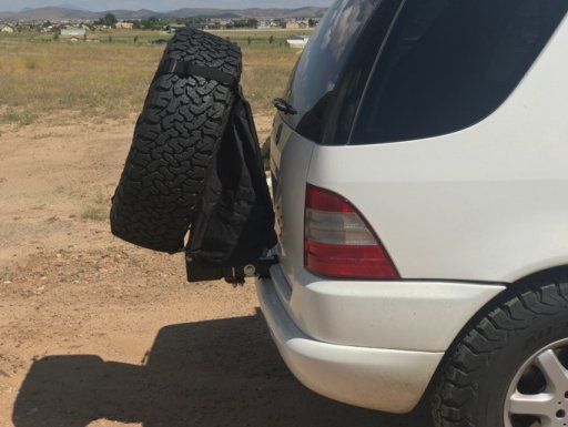

I added a rear tire carrier and a roof rack. The tire carrier is a tricky problem to solve. The easiest way to do it is to get a hitch mount tire carrier, but these tend kill the departure angle and stick out too far behind the tailgate. I flipped the hitch upside down to save the departure angle, and have a firewood bag attached between the tailgate and tire carrier to minimize it he gap.

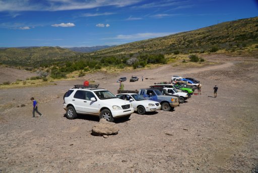

I installed a pair of 40mm strut spacers for a 4” rear lift. I added 30mm wheel spares all around. The front torsion bars were cranked (not indexed) for about 2” lift. It’s a little raked forward, but I’m fine with that. If it bothers me I’ll index the torsion bars one day. I stopped by Sedona on the way to Overland Expo in Flagstaff last week, then this weekend took it from Cave Creek Rd to Bloody Basin with the AZ Gambler 500 crew. It drove well and was a ton of fun.
