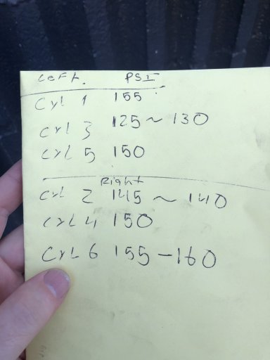

TL;DR - my ‘02 Tacoma’s head gasket is going south, and I need some recommendations in SoCal.
My taco’s HG is on its way out, like many other 1st gen 3.4Ls before it, around the 210k mile mark.
Symptoms: Rough starts after it sits a while, very reduced MPG, losing coolant, and sweet, white smoke from the tailpipe more and more often.
I’ve done a compression test, and have low compression in cylinder 3:
I wish I was more mechanically skilled so I could redo the top end myself, but I am not - and I certainly don’t have the time to learn and try.
Does anyone have recommendations for a shop in SoCal that I can reach out to for a quote? I’ve got two so far, and they are pretty close to each other.
Probably gonna change the water pump and timing belt at the same time since we’re in there.
