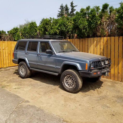

So I thought it would be fun to do a build thread for this XJ I have right now. The previous owner had done some work to it but as I have looked over it I dont think their attention to detail was quite what I would call acceptable. LOL so I'll be going back and fixing everything to my OCD levels. :)
I will probably keep updating this list below as I pick up more parts since I already know I'll forget something.
Anyways what the jeep has right now:
- Dana 30 Front
- Dana 44 Rear
- ARB lockers front and rear
- 4 inch Rancho short arm lift (which I have mostly yanked out by now)
- ARB bully front bumper
- XRC 9500 winch
