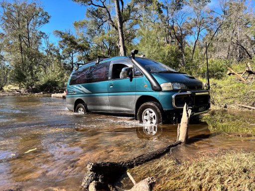

I used to have one in Australia. I lifted it approx 2". Like most independent front suspensions you can't go too high without stressing out the CV joints. basically just springs and dampers.
Snorkels are a popular accessory here, the series 2 (96 onwards) one fits but overlaps the RHS indicator and you don't use one of the bolts. Requires a different template to the later model.
Being a series 1, the fuel pumps don't like sitting around, as it would have been, so keep an eye on that. Being purely mechanical it may be better in the long run once reconditioned.

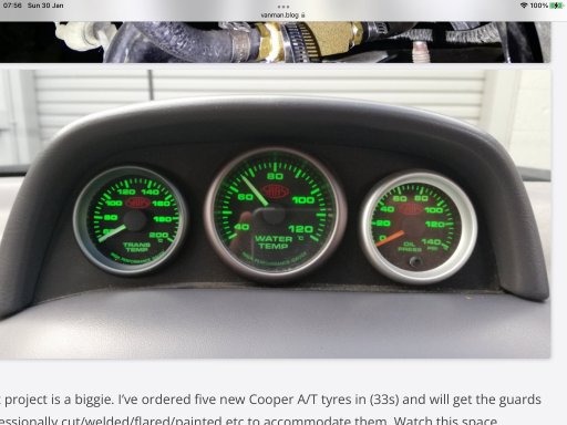

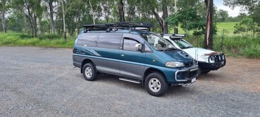

I have a 1994 LWB, some of the best mods done was the dash pod, putting in gauges that work, also removing the plastic heater hose tees and putting in aluminium ones.
I opted for airbags in the rear keeping the standard 29" tyres for fuel economy.
