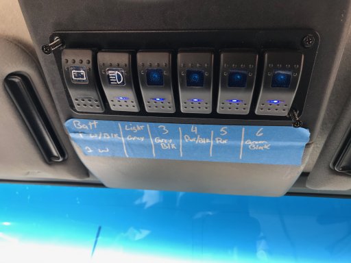

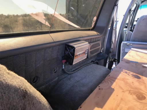

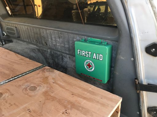

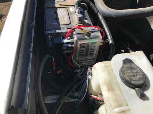

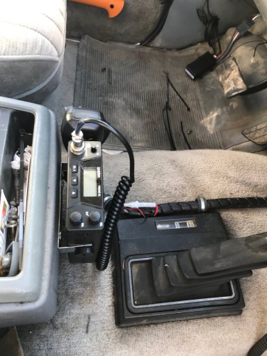

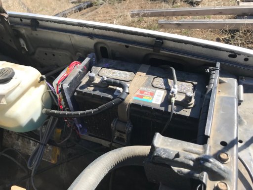

The other area that I have been working on is the electrical. My original set-up had a solar panel on the roof and the rest of the system including the battery in the spare tire well. I did not like this for several reasons.
1. the tire on the roof was hard to get to, exposed to to UV rays (harmful to rubber).
2. The system did not charge while I drove around in the shaded areas. So, but night 2 the battery was dead.
3. It was a mess of wires and "stuff" in the back that just looked bad.
4. I did not want all the weight on the roof, and the solar panel is prone to break.
So, my solution was to move the battery up to the front under the hood. I made a new rack out of aluminum angle and bolted it into the front of the engine compartment.
I ordered a fuse panel, large relay, some small relays, and a switch panel. I also ordered some 9 conductor cable.
In the engine bay I installed the fuse panel, large relay and small relays. The large relay is controlled by a switch in the overhead console. I can turn it on and the relay will power and send power to the second battery to charge it while driving. This will keep it topped off all the time. The blue tape is just there to remind me of the wire colors, it will be gone soon. I am still in the finishing stages here, so there are wires to clean up and a few other things to finish, but it all works.
The small relays power the the front light bar, and will power other things in the future.
I also ran a large wire to the back and installed the Inverter for my wife's CPAP and anything else we need.
Up front I installed a new CB radio for communication on the trail. A GMRS will soon follow. I do have a handheld Ham, but still need to get the licence.
I also added this really nice vintage First Aid box. Don't worry, the contents are new and I will still add some more to it.
Very nice, you have your act together. You have two batteries right ?

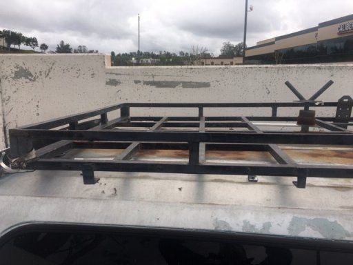

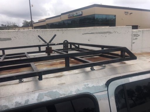

this is my rack I got for free off another rig. I am going to be cutting and welding some new bracket along with extending it the full length of the roof. That is my next project. Just working on the best way to mount the brackets and what to make.burb rack 2.jpgburb rack 5.jpg

this is my rack I got for free off another rig. I am going to be cutting and welding some new bracket along with extending it the full length of the roof. That is my next project. Just working on the best way to mount the brackets and what to make.View attachment 144848View attachment 144851
Looks like a really nice sturdy rack. I would love to find something like that, but I have already started on my own rack and have too much invested.
When you make mounts for it, be sure to check under the headliner. There are cross ribs, you will want to use those and mount over them, or very close to them. If you don't, the rack will bounce and cause dents at the mount points when you load it. That rack is already very heavy, your mounting system will need to be well though out.
I am focusing on packing as little as possible and packing everything I can inside the truck low under the bed. I plan to use the roof rack for my High Lift Jack, shovel, axe, and traction boards. I may put a box up there for recovery gear, but will try to keep it light.

When I start, I'm going to be removing my headliner and fixing the mount points directly to the ribs and then seal them up real good and then fasten the rack to the permanent mouts. then rhyno line the roof complete for additional protection. that's what I'm thinking now anyways.
Good pick. Do you have roof gutters or is it like the picture shown. Mine is very similar (made in Africa for safari's) except for mounting. I have gutters to mount too, and is full length.
No gutters .... that is why I was reaching out seeing what others have done. My basic mechanical mentality will be to remove headliner and make brackets off or roof reinforcement beams that stick out of roof ,seal them, then bolt rack to those brackets for maximum strength. Don't care if its the prettiest just the most easiest functional way I can.
If it dosent have factor rails I'm sure it will be difficult if you have to remove the headliner. I'm not that brave. I'm surprised there hasnt been a lot more suggestions for your questions. I'm sure someone has done it before.

Go to the junk yard and purchase factory roof rack rails for the base of your mount system. They can be had for under $50 for a pair with cross bars... then sell the cross bars for what you paid for the whole system on CL. After that, it gives you a clear slate to use production type mounts, or choppy production mounts.
That would work, but the factory roof racks for a Square body Suburban are rare at best. Finding one in a junk yard for a 30+ year old Chevy will be an extreme find. Then the factory roof racks are weak, they were never designed to hold the kind of weight he wants to put on there. From his picture, he already has the factory rack anyway.
I have done what he is asking to do. And as I have suggested it is going to require pulling down the headliner and finding the factory ribs. These go side to side and provide support for the roof. This is where the structure is that he will need to tie into.
I have been down this road and there is no easy off the shelf answer to a roof rack for a vintage Suburban. However this is part of the fun for me. With enough money anyone can build a Jeep or a 4Runner, just keep throwing money at it, but you have to get creative to build a vintage full size rig.
