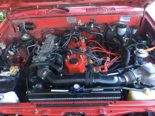

Mod. Specs.
- Raceline w/ 285/75r16 (32"-33")
- CD Player "Joshua Tree, War, Unforgettable Fire"
- 4" Lifted w/ Bilstein 5100 Shocks
- Marlin Crawler 4.70
- Quik Lok Differential
- OME 33 Steering Damper
- Capacitive Discharge Ignition (FAST Pro Street)
- Flex Fan
- AC Upgrade to R134 (Wifey Request), also must have Mirror in the truck.
- Smittybilt Roll Bar and Bumpers (Front Tube Coming Soon)
- Waterproof Relays (60% done)
- Lighting almost done ...Fog and Bed are next
- Hand Winch at Front..need to work out details with Tube Bumper integration.
What Next?
Mechanical Integrity First...then Cosmetics last.
- Power management for rear LiFePo 2nd battery...
- Auto Door Lock
- Lots of electrical upgrades (security, switches, alarm mod., sensors, mechatronics)
- Waterproof slowly to 3 ft min...ECU is the next big challenge.
- Cat back exhaust (MagnaFlow)...currently stock Bosal.
- More Lights
