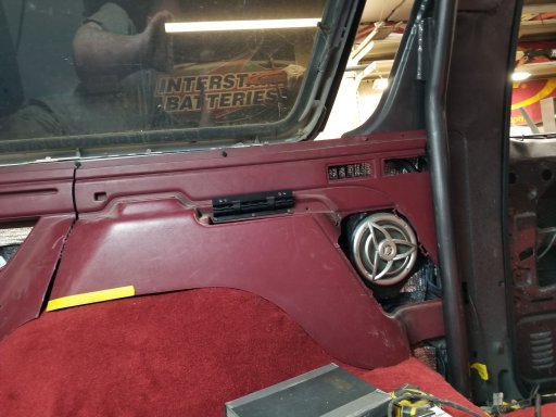

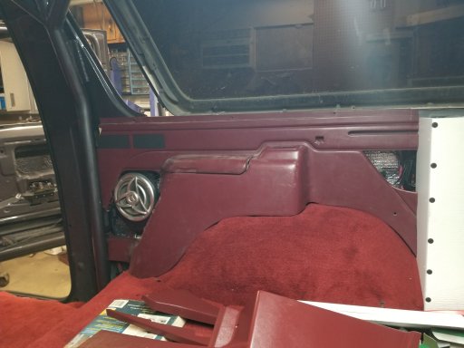

I got the rear speakers in and started the enclosure for the battery.
I have a little more wiring to put in then I'll tidy up the wires more.

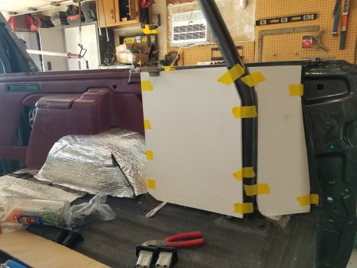

I trimmed the original panel and cut some pieces from 1/2" pvc panel and shaped it to fit over the electronics and around the roll cage.
It needs some fine tuning yet. But it's a decent start. I will be adding some usb and anderson plugs. Also plan to texture and paint it to match the interior panels.

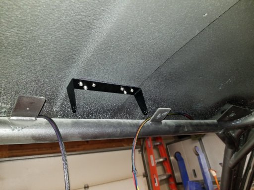

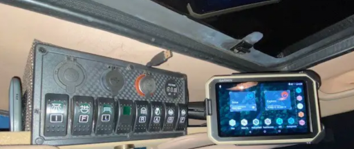

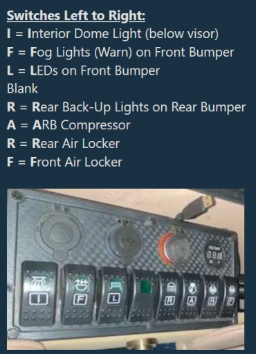

Did a little wiring on the upper switches in the front this weekend. I figured out the location and drilled some holes for the nutserts.
The bracket in place. I ran the wires from both sides up the A pillars.
Wiring up the premade switch assembly. It came prewired but I'm running relays on the ground side so had to switch some wiring around.
And it assembled with weather pack connectors. Complete with some extra for potential additions or repairs down the road.
Switches mounted up high.
Then I trimmed up and managed to fit the headliner back in place. I still have to trim more of the plastic trim to fit.

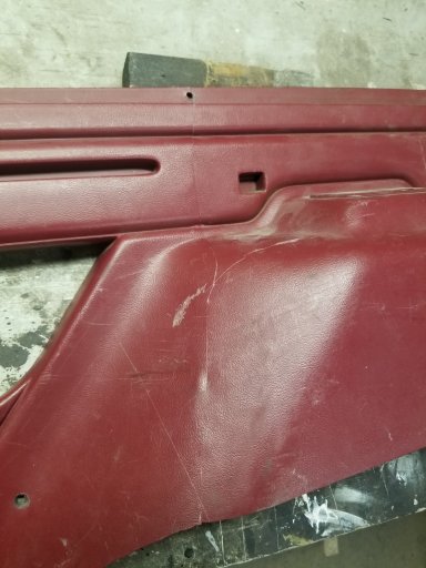

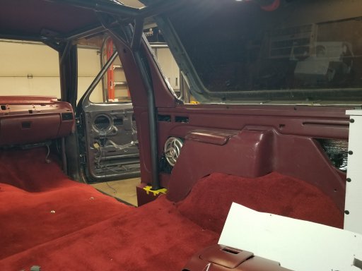

Started trimming more of the interior panels to fit around the roll cage and other modifications.
The kick panel and A pillar parts took the longest so far.
2 more to fit on drivers side and then long cleanup and color match work. But closer every time I make it out to the garage.

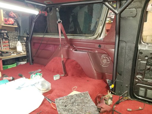

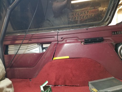

Had some time for more interior work. Got both rear panels trimmed to fit.
Now it was time to make some repairs. So I cut some leftover parts into strips and figured I'd play with homemade plastic welding
I used a hot air tip on a butane soldiering gun to melt the plastic together and used the cut strips as filler material.
Not real pretty bit seems ok. Also used some plastic repair staples and then melted a wire mesh into the plastic. Then finished the backside off with plastic weld epoxy.
Turned out ok. We'll see how it looks after prepped and painted. I also made and attached filler pieces. One will be used for rear seat usb power ports.

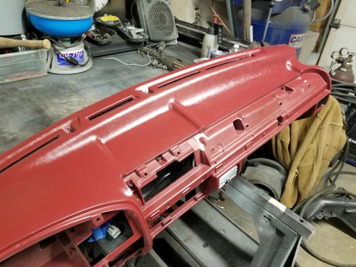

After getting it put together. I put some extra sound deadening material on the back side. Along with covering the opening I made to clear some things with a speaker covering fabric.
All cleaned painted and installed.

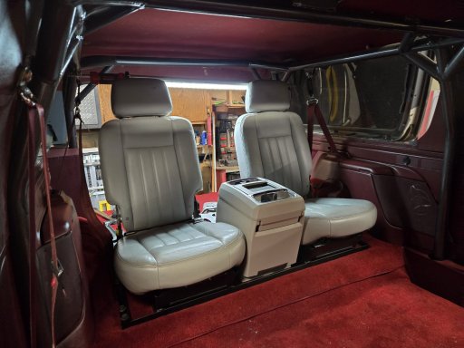

Rear seats for the kids. If we like them I'll probably change the color in time.
