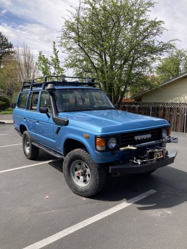

Features
Chevy V8 "Vortech" L LM7 engine with 862 heads
Aluminum radiator
New Venture 4500 manual 5 speed
Toyota OEM PTO winch
Non-USA cable locker front axle
Non-USA cable locker full float rear axle
Nitro Gear & Axle 9.5 Full Float FJ 60 30 Spline Chromoly Rear Axles
16”: steel wheels with Cooper Discoverer AT3 LT 265/75 R16 tires
Custom fabricated front bumper with Hi-Lift jack mount
Custom fabricated frame-mounted rock sliders
Custom fabricated rear bumper with integrated towing harness and receptacles, integrated hitch mount, and frame-mounted 3/4 panel sliders
Trailer cam wiring harness outlet with video monitor in the cabin
Trailer brake controller
Headlamp guards
Bosch External temperature gauge
Alpine stereo with speakers in all four door panels
Wagongear seat box (storage under front seats)
Wagongear tailgate storage lid
Wagongear side panel with storage hatches
Rear cargo area load tie-down rails
Rear cargo area D/C outlets (2) with control switch in the dash
Temperature gauge
FJ62 rear bench seat with headrests (2) and 3-point seatbelts (2)
Non-USA passenger seat dash grab bar (leather covered)
ARB Old Man Emu 2.5” lift kit (shocks and heavy-duty springs)
ARB steering stabilizer
ARB snorkel (Land Rover style intake filter)
ARB full-length aluminum alloy roof rack
ARB onboard air compressor with dash switch
Headlamp guards
Differential breathers
U-bolt flip kits front and back
Custom fabrication recessed rock slider shock mounts
SOR Tuff Duck seat covers on the front and rear seats
