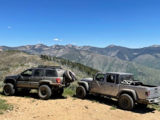

You'll prob have better luck on the WJ Facebook Groups (as scary as that is) with this specific of a question. When I still had stock axles/brakes because all my research said 15"s wouldn't clear. That said, steelies have more clearance *generally* and it's going to come down to our exact wheel/offset combo. I liked 16"s just fine on my WJ with the 32"s and still run them now with 35"s:
