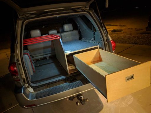

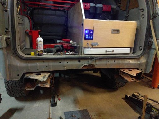

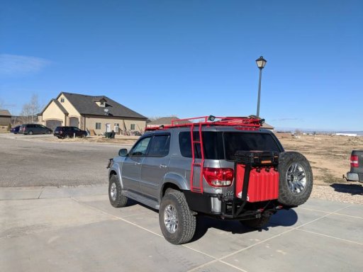

She joined the family as a salvage vehicle with a rebuilt title.. all stock. 6 months later she's riding on Bilstein 6112 front coilovers with SPC upper control arms, with OME 2860 rear coils paired with OME 60071l Nitrochargers. Done it all my self. Roof rack, lights, storage system with 5 gallon water tank,12v pump with sprayer attachment. 2x18ah AGM batteries to run aux plugs, water pump, and overhead lights I installed into the lift gate, 24x48" table storage and storage rack in rear. Custom home made steel bumper with swing outs. On board ARB compressor plumbed to from and rear. Next project is my rock sliders.. steel is sitting in the garage.. been too cold to work on them last few days. Glad to be part of OB! IMG_20181229_073309.jpegIMG_20181222_111645.jpegIMG_20180924_230908.jpegIMG_20181115_194824.jpeg
