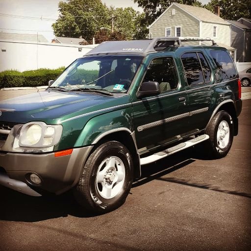

Congrats man! Good looking first gen!
I've got an 03 myself, and they're a great rig for overlanding.
First thing I would recommend is ditch the mud flaps and step bars. They get hung up on things, and the step bars are thin aluminum, and are known as damage multipliers.
After that, I'd try and confirm the water pump and timing belt were serviced at the required intervals (105k). If not, I'd have both of those done (or do them yourself, if you're able).
These rigs are surprisingly capable in stock form. You can however lift about 1.5 inches just by cranking the torsion bars a bit, and putting some longer shackles on the leaf springs. This should allow you to run 265/75r16s with minimal rubbing.
Honestly, unless you're doing some seriously rough stuff, that should be about all you need.
I'd recommend carrying extra fuel though, as the VG33E is a thirsty engine, and I'm lucky if I can make it 250 highway miles on a full tank of 19.5 gallons.
Feel free to ask any questions you might have. I'd also recommend visiting xterraNation.com. These guys know these rigs inside and out.

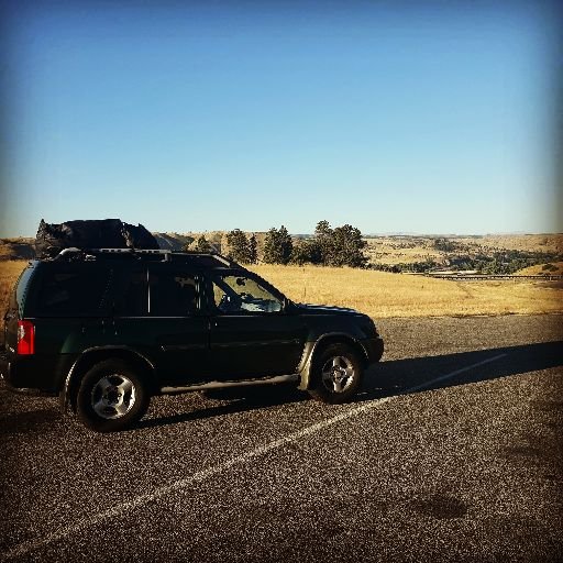

Thanks man, i appreciate it. I just completed a cross country trip with it.. 2,600 miles loaded and it was a dream! Only issue was it started shaking a bit at 70mph.. figure that should be corrected when i do the suspension.
The carfax shows all the maintenance was done by nissan. I will give them a call to check about the timing belts.
Not sure where you guys are from, but i picmed up from new york and am currently in Idaho. I want to check out the idaho backcountry discovery route.. figure Missoula, MT to Lewiston, ID would be a good route for me as a beginner. I still want to wait until at least a lift, plates, and tires.. maybe in the spring.
I was getting about 200 to 250 miles on a tank on a flat surface.. not sure how it would handle that route with no gas stations.
It was aweso.e to drive, im glad i made that choice, its a great truck so far.
