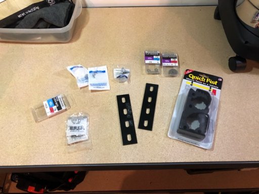

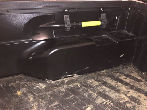

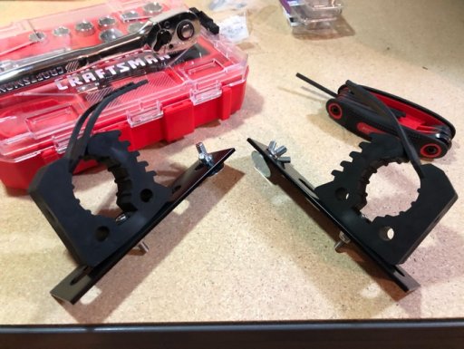

Shovel/Axe Mount:
Decided to go for a drive by myself last weekend to spot out a few trails to take my girlfriend on her first overnighter. On my way out of town I realized that besides a spare tire, jacks, jumper cables, a few tools and a ham radio I had no recovery gear whatsoever. So I stopped by Harbor Freight on my way out of town to pick up the only thing I could get at a moments notice...A shovel. And the only thing I heard all day were the sounds of the forest, my truck, and the stupid thing bouncing around in the bed.
Naturally, I began scheming up a solution. After seeing some YouTube examples and high-priced prefab options I decided this mount was something I could piece together in the hardware store (well, except the Quick Fist which I promptly ordered off Amazon). This was pretty simple but my challenge was sorting through the countless bolts and nuts to find the right combination. I ended up needing a 4” drop from the T-Slot rail to fit the shovel securely above the fender well. I’ll list the parts below:
2x Elevator Bolt (sized to slide perfectly into the t-slot)
2x Wingnut (for easy movement and removal)
2x 6” Steel Brace (these were pre-drilled and sealed)
2x #10 Bolts, Lock Nuts, and Washers (sized for the pre-drilled holes in the brace/quickfist)
Seeing how this turned out I definitely plan on getting an identical setup for an axe on the other side. Here’s some pictures of the process:

That will work! I don't cary a axe, I do have a saw. Taco's are good truck that can take to fun places.
Make sure you girlfriend has a great time, cook and clean, favorite drink, bathrooms comfortable sleeping . If she is new to camping make sure she doesn't have a bad time, shell never go back.
