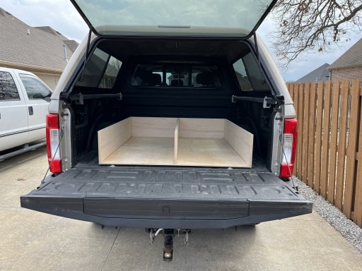

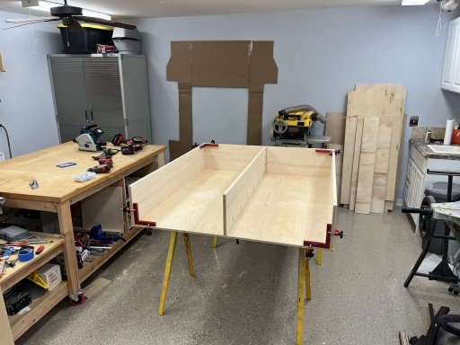

Made a template of the bed floor to help with layout of the components.
Also the first shipment of stuff has arrived for the build. All of the colored wire for the different circuits, The Blue Sea 12 position fuse block, lug connectors, water pump screen filter and pressure tank. I will use the template to lay things out before I cut anything.

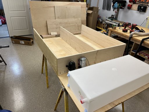

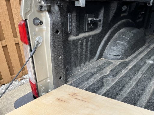

So went back to the drawing board and decided to rebuild the base cabinet so that it will fit between the wheel wells from front to back. I plan to build out a face plate over the front and tie this into the tiedown points in the front and the rear of the bed. I think this will work out best. It will also provide a totally enclosed drawer to help limit any dust from getting in them by using felt seals. I am no cabinet maker so I was pretty excited when I stayed within a 1/16th of inch between the two drawer cavities. I glued and screwed all of the panels together using waterproof glue and Kreg pocket hole screws. The front area will be for the utility stuff like 21 gallon water tank and on demand water pump and power management.IMG_5734.JPGIMG_5733.JPG

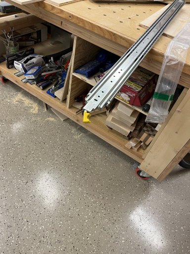

So here is wat I have been dealing with on the drawer slides. This is the 4th time this pair of slides had been ordered. Again these are 52" full length heavy duty locking slides. Notice the bent locking lever. Instead of returning them again I worked with them to get the locks straight so they will work. In a pinch I could get by with one locking slide per drawer and just remove the locking devices from the beat up pair.

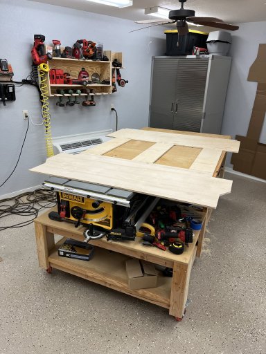

I'm not sure what I'm more excited for. The project or the shop layout and mobile project table. LOL. Nice work Sir. And nice shop too.
I just switched to Milwaulkee so I've got to make a shelf organizer too.

I did start some layout for the water system. The 21 gallon take looks like it is going to fit great and I will have a good place to mount the pump and surge tank.

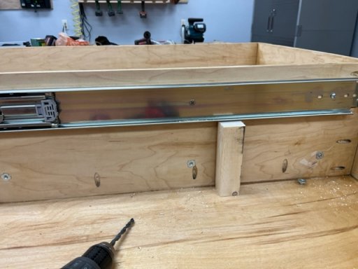

Made some more progress this weekend. Got the drawer slides mounted with a little help from my right hand man. We used T-nuts to attach the slides to the structure. The slides on the driver side were set lower than the the slides on the passengers side. Reason being is the location of the secondary slides for the stove and sink.

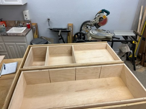

Got after it and managed to get the drawers built. Drivers side will be setup with moveable dividers for varying loads. Passenger side has varying depths of compartments to accommodate kitchenware, dry food, and miscellaneous food.
Driver side below
Passengers side coming together
Here they are both at home. Next is to build the sub-drawers for the sink and stove.
Next to put together the sink slideout drawer.
