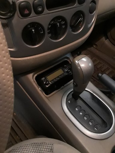

Still not quite done, I need to make a filler plate. But the Escape had this little cubby hole that I never really used in the center console, so I popped that out. When I did that my 12volt power point went with it, but since I never use my cigarette lighter I removed that (its up by the temperature control knob for the HVAC) and moved the 12volt power point up there.

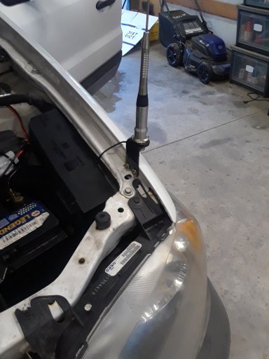

For the antenna mount I scavenged an old hub odometer mounting bracket out of the scrap bin at work and modified it slightly. Im still not 100% on where its mounted, but that was the easiest spot. We will see if I decide to move it.

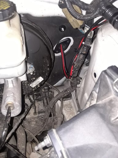

Running the cables was super easy. This body style of Escape still came with a manual transmission, so I just cut a small hole in the grommet where the hydraulic clutch normally mounted and ran everything through that. Then I just zip tied everything up to existing harnesses through the dash and down into the center console.

Met up with WU7X ( member here and long time friend, and the guy who gave me my gear) to get the antenna tuned, I'm running about 1.4 SWR.
That's honestly not bad for a mobile installation. I like how you were able to use the console and grommet holes.

That’s a clean install buddy, can’t wait to see the trim ring done... it’s going to look amazing
