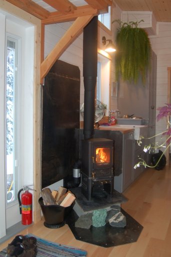

Heres one I installed a few years ago, this is what i do for a living.
The next choice would be a wall tent tin stove. Incredibly light but still not at all efficient even with the bigger firebox you'll likely only get a 4 hour burn. These are acdime a dozen in north America. Not sure about Europe.
