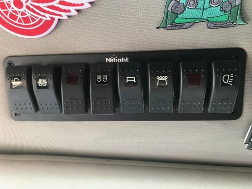

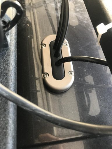

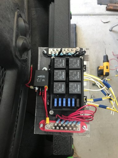

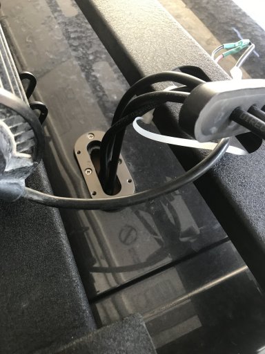

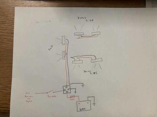

i bought some 4-wire cable and a marine wire block deck seal. i have 2 lights each on both sides and then two front lights on my rack. i wired the lights in series. ran to a 8 gang switch panel in the headliner controlled by a relay bank under the hood. there are kits that are nearly plug and play Auxbeam light kit but i like to DIY alot of stuff. this set up runs all the exterior lights on my truck. everything runs under the headliner and through the A pillar. only 'messy' part is my relay set up. however maintance wise i have a lot more control than a sealed junction box. ill have to look at it again and remember exactly how i wired it. i may still have my homemade wire diagram around some where.

That deck seal is nice. I haven't seen that design before. Is it sealed by the clamping of the two halves or is there a gland nut inside the housing? The description from the link is a bit confusing.
You bolt the base plate to the roof ,then the top piececlamps the rubber seal.

So a correction to the above. I used a 2 wire cable for each pair of lights wired in series, and used 2 each 4 wire cable for the switch to relay wiring.
