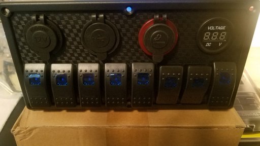

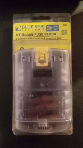

So much like yourself, I wanted a less pricier solution to my lighting because there will be alot on The Black Pearl. I did some digging and this is what I found. Blue Sea fuse blocks and Waterwich control panel. Small cost compared to SPod and reliable. I think you can get the control panel fitted for your Jeep exactly with this company also. Hope this helps and good luck. Can't wait to see your finished product. View attachment 87801 View attachment 87802 View attachment 87803
