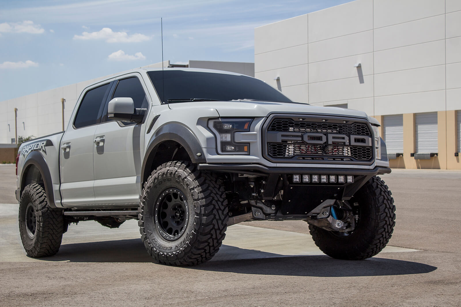

your going to have to relocate your intercooler if you want something hidden or a bumper that doesn't stick out a foot. I have a 5.0L but I also didn't like any of the bumpers out there so I had Mercenary offroad build mine so its nice and tucked away..3fefe6929b2c90b1605ff096d7cdf1af.jpg
