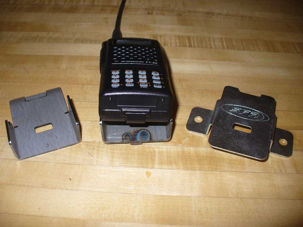

I am aware of two makers of mounting brackets for the Baofeng UV-5R, and I think chances are pretty good the new BF**-8 radios will fit as well. Stinkyfab Racing (SFR) is one, and Kiddmen57 on Expo is the other. (Not posting links because as a newbie the system tells me those will likely get flagged as spam. A search function should get you there though.)
Here is a picture of the two brackets with a Yaesu FT-60 which doesn't quite fit either one.
The SFR bracket could be easily modified to take the Yaesu, but not the Kiddmen57 bracket.
Note that there are two versions of the Kiddmen57 bracket, one has a 1/4-20 nut welded to the back. There is also another version of the SFR bracket available, designed for welding to a roll cage, but I did not order one of those, so no pic of that one.
Awesome! I will check those out. I discovered yesterday that with the extended battery on it that makes it longer. It just barely fits into my current ram mount for iPhone however that's a temporary solutions.
