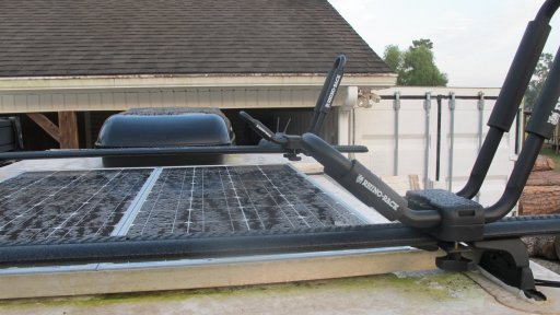

my square drop (5x8) has 200w and a 100ah agm battery that runs everything including a 65qt dometic fridge. space is an issue on a small camper, so i mounted the panels under the yakima rack using aluminium angle...this way my panels are not touching the roof nor are they sticking above my rack so i can use the rack with no problem. loading the rack will block some of the sun, but once on location, i can remove items in the rack and get full sun. best solution i have found, including using the flexible panels.
we move around a lot, so portable panels wont work since we drive during the day and stop when its dark....even with some of the panels being blocked by items on the rack, i always get a full charge during the day and have plenty of power at night. i just ordered whatever agm battery had high reviews on amazon. this is the one i've been using for 2 yrs now with no problems
