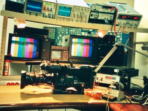

That sounds like a cool job. Retired Broadcast Engineer here. We shot all the GPS Sat launches at Canaveral you would see on the morning news years back. Small world…
