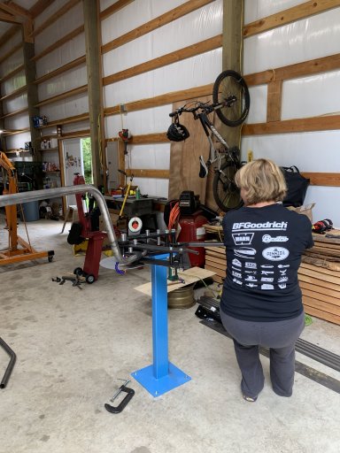

The Box is mounted on the new frame for mock-up and it’s finally time to start making fenders. The wife and I started bending tubes and came up with the fender line that follows the one on the rear of the JL reasonably well. It’s still in mock-up (the tongue will be shortened after the fenders are done.) but I wanted to get it one the ground and take a peak. Super Happy with how this is turning out so far.E8E00DB9-037A-4EFD-92B8-A13EEA732DE5.jpegF7608CE4-8DDF-4E66-8250-0F1E5B2B0B4B.jpeg
