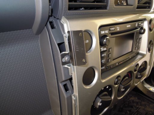

Here's the product I found online. Basically you remove the trim by the radio using a philips head screw driver and by prying it from the bottom and working your way up. Remove the screw that hold the radio trim in place and that same screw will be used to mount this bracket. You then reinstall everything. Simple enough

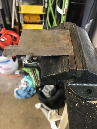

I then started making some measurement and drew out a rough outline. I made my bends by using my vise. By hammering the edge against the vise I was able to get a nice sharp edge on the metal.

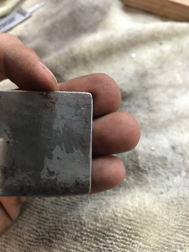

At this point I had realized that the hammer marks were going to be a pain to cover up so I would end up using plastic dip for paint to cover up as much as possible. I realized I wanted it to be as small as possible so it could have more rigidity so I trimmed some of the top section off. I finally rounded out the edges with a file and prepared to paint.

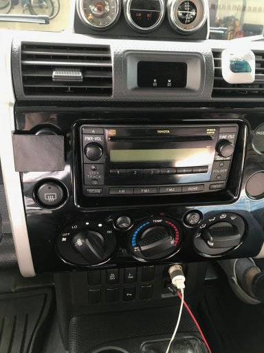

I installed it and put the trim back on. You can still see the surface is not perfectly smooth but I knew this would be covered by the actual phone holder so I wasn't too worried about it.
Here's the final product. I like using the magnetic phone mounts so that's what I chose to install by using 3M double stick tape. It worked out great and I'm still able to have access to the hazard lights and rear defroster.
