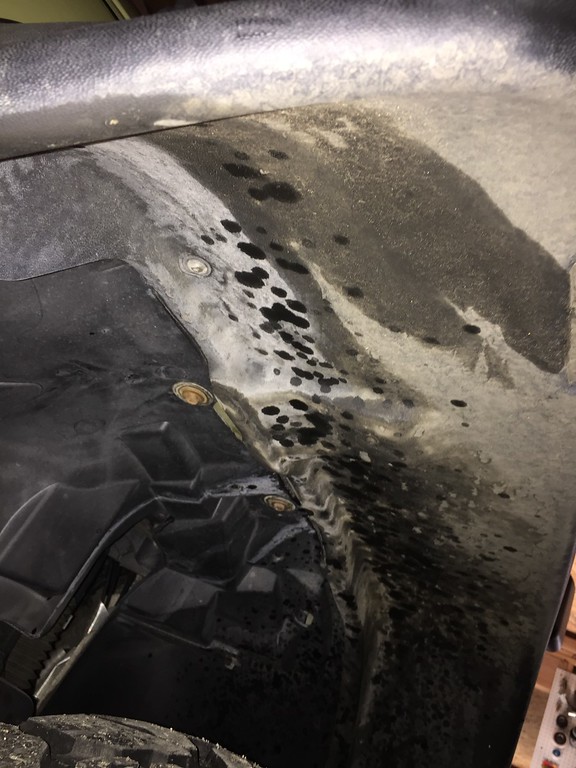

But, I digress. When we got back to town, we stopped by a self wash and thoroughly cleaned the grunge off. I pulled the shiny clean Jeep into the garage to do some maintenance - oil change and tire rotation, and was a bit miffed to find this…
One of the telltale signs of a bad axle seal. Gear oil spray on the inner fender well. ARRRRGGGHHHH! This was not readily apparent when I was washing off the mud and ice from the wheel well. Not a critical failure in the general scheme of things, but an irritation none the less. Especially since replacing these particular seals requires removal of the carrier in the diff, as well as the wheel/brake/hub bits. If the leak or damage to the seal is bad enough, you can loose your gear oil at an alarming rate, and/or dirty water can end up in your diff from fording the errant stream. Mine is not there yet, and this seems to be a very new leak, like just started on this trip.
This is a relatively common failure on off road vehicles that actually see off road use, at least on Jeeps, Rovers and older Toyotas. I’ve replaced many axle seals on all of the above - much easier on old Land Cruisers and Rovers than Jeeps…
Another story - a couple of years ago I was doing the same post adventure cleaning and inspection on my Rover Disco1 and noticed a little weep in one of the steel brake lines. It was very minor, but noticeable on the freshly cleaned line and undercarriage. I ran to the local parts store and bough a replacement line. I lifted the rear end to remove the wheel and create some working space so I could replace the line, and SNAP the line broke. As it turns out, the plastic anchor on the axle housing that prevents the steel line from flexing had broken, and the articulation from lifting the chassis had strained the line and snapped it at the weak point.
This was an easy repair, but could have been a catastrophic trail failure. I would not have found this had I not take the time to thoroughly wash all the mud and grime from the rig and do a quick inspection. The lack of significant articulation of the suspension in daily driving would likely have meant I would not have noticed anything until my next dirt excursion that forced significant suspension flex. Then it would have been too late - out on the trail and no brakes!
