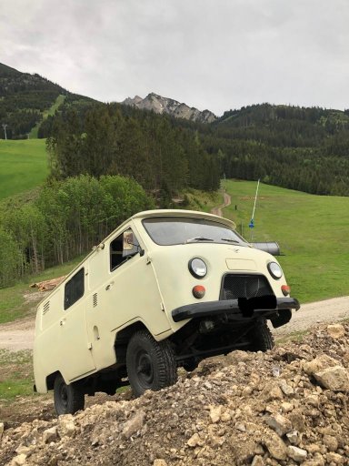

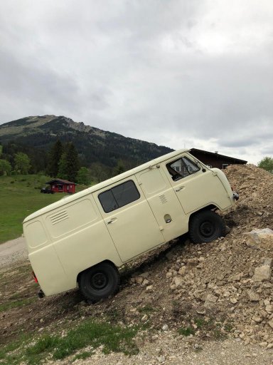

Then I found a very old UAZ in Austria on the internet for sale. If I wanted a Buhanka then it should be very old since this has a lot of tax and rules benefits here in the Netherlands. So we drove to Austria and did have a look at the UAZ. Then we drove the UAZ on a ski slope during summer time. The seller was driving in front a steep hill, stopped, put in 4x4 and low-gear and there she goes! It is such an awkward feeling and sight when you see a van go up such an angle (especially when you are from the Netherlands and everything is flat.. LOL). I WAS SOLD!

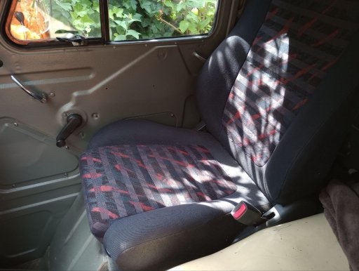

When the weather and shoulder slowly went better I started to work on the UAZ again. First I wanted to fix the front seats since they were crappy and not fasted to the car(!). I managed to find late 90's Toyota Corolla G6 sporty interior and customized the metal frame to fit in the van. The seats barely fit and had to grind and weld couple of times to fit it perfectly. I really dig how to seats feel and how they look. They look very similar to the livery of the Japanese HKS brand. I kept the fabric of the rear seats to reuse it in the interior of the UAZ later.
Snug fit between the door and the engine lid in the middle.

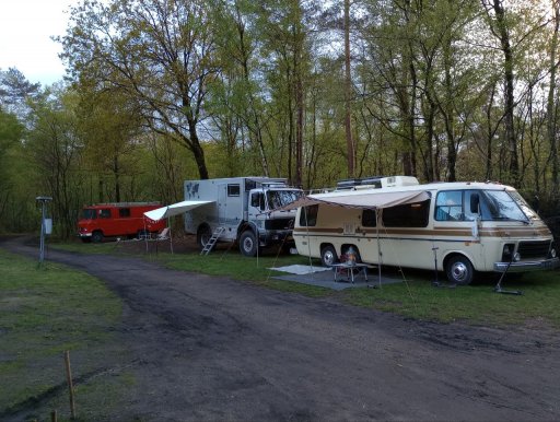

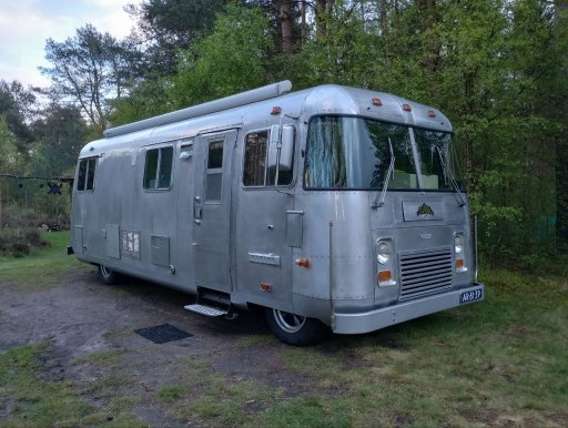

Then I went to a little festival on a creative camping ground for a weekend which you could only go if you had a non-normal camper vehicle. There were a lot of cool vehicles from vintage American ones, a lot of old German firetrucks converted to campers, old London bus converted to a driving hostel and so on. There was live music in the evening at the big living room of the camping. Weather was wet and cold but really enjoyed it! The vibe was great!

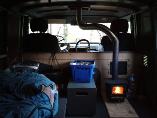

The old UAZs have a service hatch in the roof which you can unscrew to let a hoist get through the roof for lifting the engine. I made up a second hatch which has a pipe through it. So can easily swap it in and out to use it for my Cubic mini stove. It's not an ideal way of heating up the van. I mean... it is a lot of work to make small wood blocks and if you are away for a long time you need a lot of wood. But for the weekend its fine and I really enjoyed the nice heat when I was sitting inside when the weather was crap.

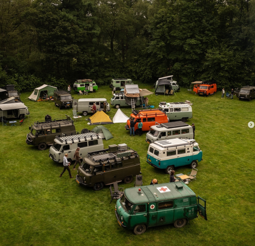

Shortly after the weekend camping I would have a new weekend camping meeting. And this was a meeting I was looking forward for a couple of years to join since you only could join it with an UAZ Buhanka. In the Netherlands there is a club for these vans and has the name 'Aanmodderaars' which means in Dutch muddlers. In the Netherlands there are around 200 UAZ vans registered on the road and about 40 vans would join the weekend!! And some people from Belgium and the UK would join as well. I found it amazing to see all those vans together on a field and one day to have a tour with them. In the Netherlands there is almost non posibilty to go offroad sadly but the organizers did put out an amazing route and with some even for Dutch standards an amazing offroad part. I'm glad to see I was not the only idiot who bought an UAZ ;)

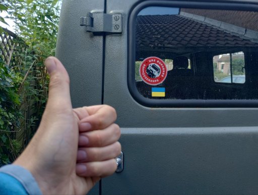

Got a cool sticker from the organizer and it deserved to be on the back of the van next to the Ukrainian flag. Don't want to discuss about politics but yes.. Putin and his friends may go to hell.

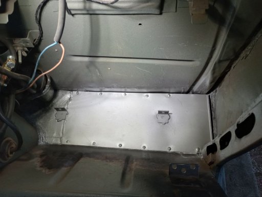

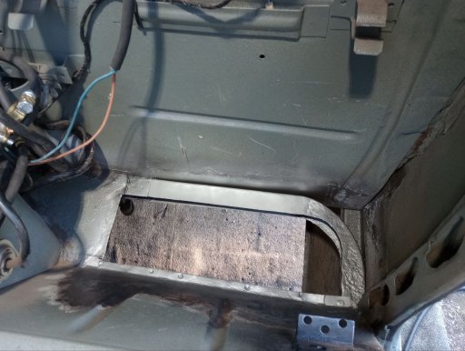

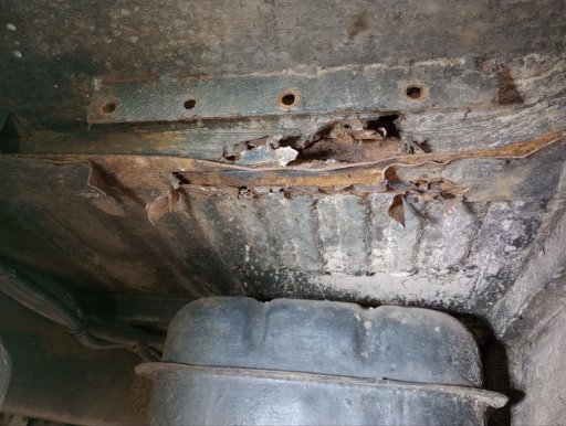

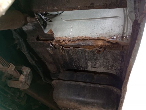

While being busy to to figure out where the new fuel and electric lines etc.. will be. I started to poke underneath around the chassis. I found out the metal area behind the seats and wheel wells were rotten. DARN more work to do.
As always with rust that is what you see is just the tip of the iceberg.
Weld some new material in.

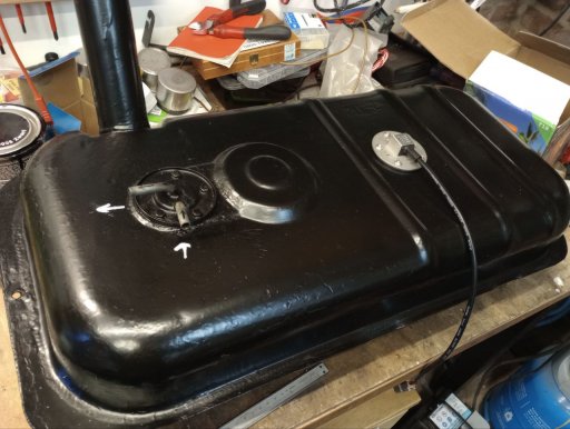

And finished welding! I've showed only one side but the other side had the same job as well. Some caulking here and there and some paint it was good to go. I did some more bodywork underneath and took out both petrol tanks and made them rust free and a new layer of paint.
One of the tanks didn't had a fuel level sender. AFAIK the UAZ should have on both sides fuel sender and with a switch you could read out each tank with the gauge. But somehow mine didn't had one nor even a hole for it.I could stick in an original UAZ sender in it but I was slowly getting tired of the bad quality these cars are. So decided to get an aftermarket one which had a tube with magnet in it or something. Cut a hole in the tank. Fill it up full with water to get the leftover gas and fumes out. Weld a ring to mount the new sensor. Cleaned it al up and painted it. And mounted the new shiny sender in the tank.

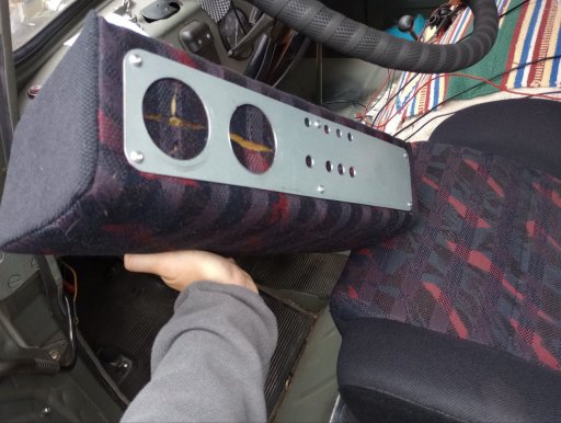

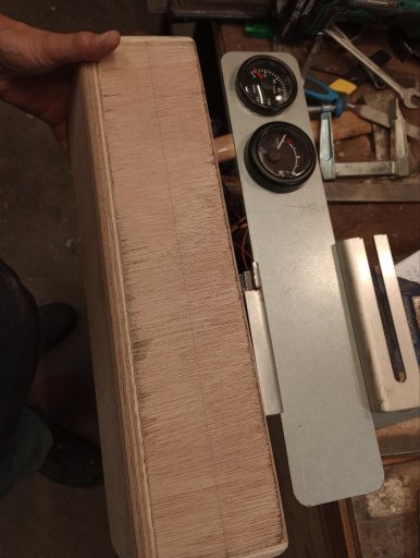

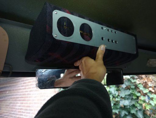

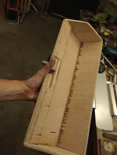

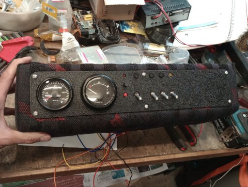

This van gives me a lot of headaches! After fixing all the random reliability issues I wanted to do something more fun. I saw pictures of the Eneos Grenadier online and it had a cool overhead console. This gave me an idea to make one for the UAZ to put in some gauges/switches etc. I started making a mold from wood. I'm definitely not the best woodworker but I gave it a try. My idea was to cover the wood with some fabric from the rear bench that I got the the Toyota to fit the front seats. I've never used to do something like sewing or stitching but after watching some youtube videos I would give hand stitching a try. And to be honest it turned out pretty well! I sprayed the metal front with VTH wrinkle paint and if may say it looks great together with the fabric. There will be a GPS gauge on the left and a fuel gauge for the right side tank. Some bulky NOS soviet aeromotive army switches which have a glow in the dark dot on the lever. Above the switches will be pilot lights with symbols in it. The small red button is to activate the fuel pump to pump over the fuel from the right tank to the left. This will be done with a timer which you can control the timing with the small potmeter sticking out the front. I'm stilly busy to make switches and little interior lights under the console and have to order some black screws for the front plate.
I'm always suprised how much time these DIY customized stuff will take. It's a lot of research...headscratching...measuring... screw it on.. screw it off.. measuring.. drilling.. on and on and on. But it's fun when it goes well!
