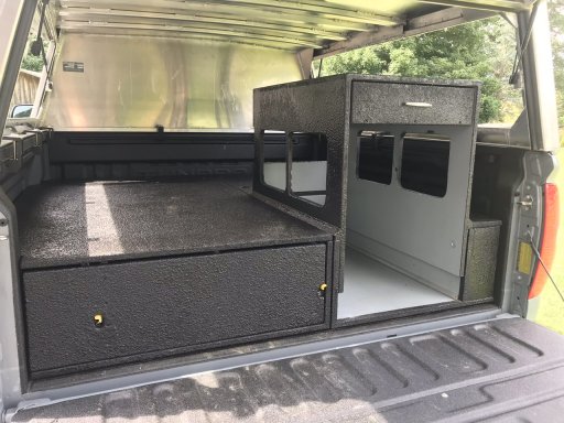

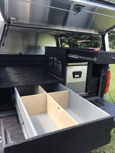

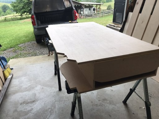

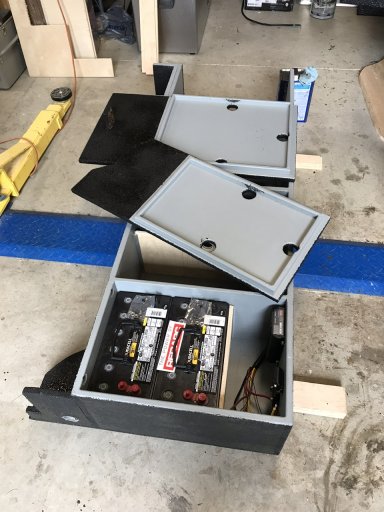

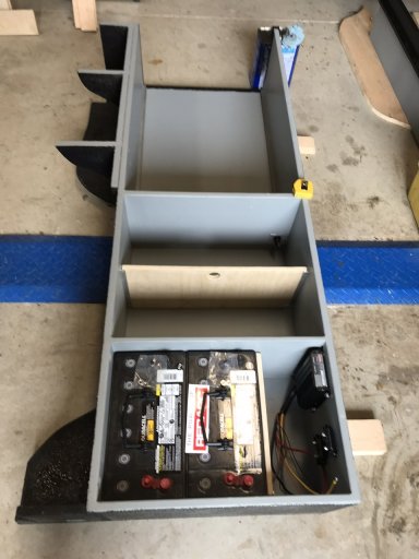

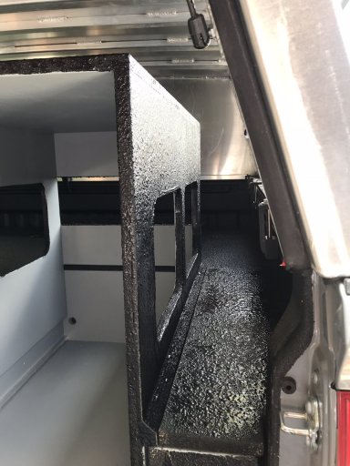

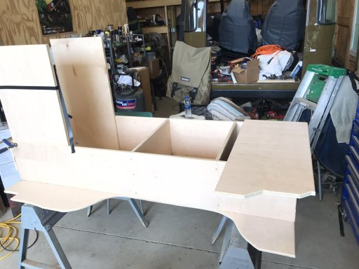

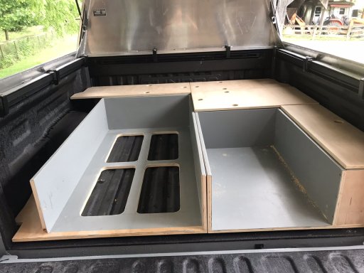

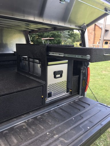

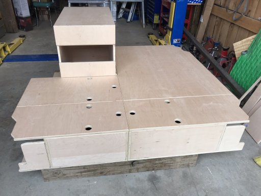

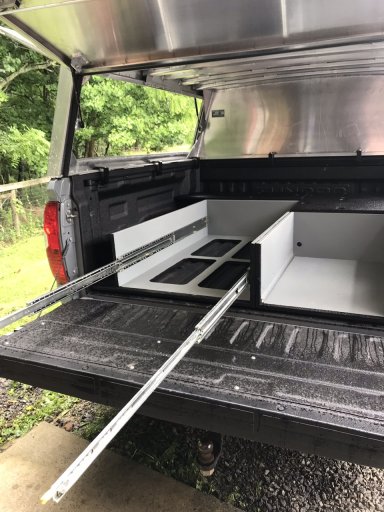

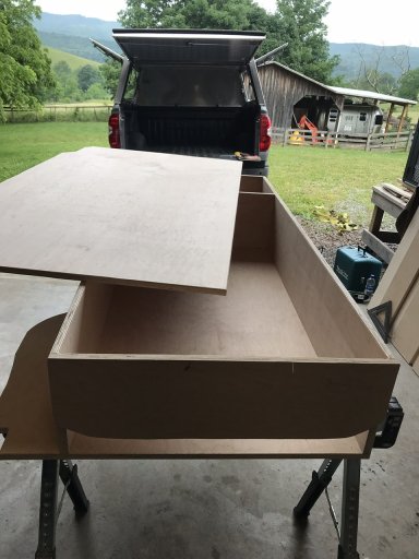

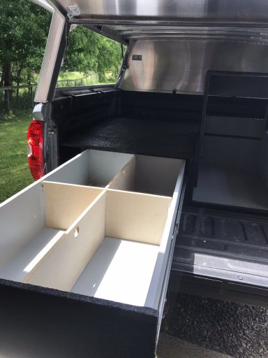

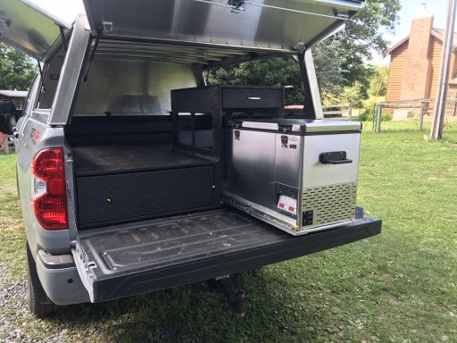

I completed the rear storage system last spring. 100% built from 3/4” maple ply, i had a cabinet maker help build the units. They are glued with fuseit and screwed together. They are built in halves. Left half has 27”x48” drawer and a top access storage in the back, the right side has 19”x30“ frig slide with two top storage section behind, one is set up for dual batteries. The frig cover and drawer can be removed. 3F6BAF2C-C81F-4D36-B1EE-957F38CC11FE.jpeg1BE0615E-8BDD-40FF-A1E8-B44D1E1509AB.jpegF6BB978F-E50C-4970-BB0F-47EE24274243.jpeg870B31EF-7EB7-4571-93D2-57D8C7C41C8A.jpegThe extreior, top, bottom, and sides is coated in two part bedliner, not store bought spray cans. Located in south western virginia. Cost $2000 to build $1100 picked up. I will be at the Overlander flee market in bedford on nov 23rd with it
