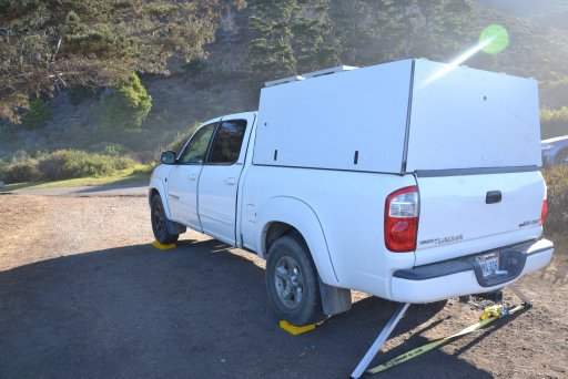

I'm probably not the only one that hates the fact that the vehicle moves so much under you with the slightest movement?
This is especially true with lots of sidewall the tire.

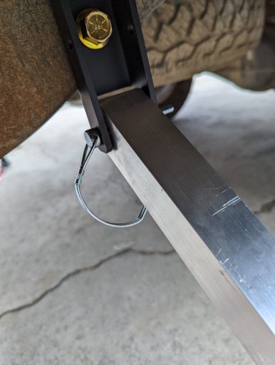

Well I fixed this with these custom stabilizers.
I designed the brackets and ordered them from SendCutSend.com
One neat thing is that I was able to make the bottom and top bracket the same part!
It bolts to an open hole on the hitch receiver.
There's a quick release pin to put the legs in my drawers.

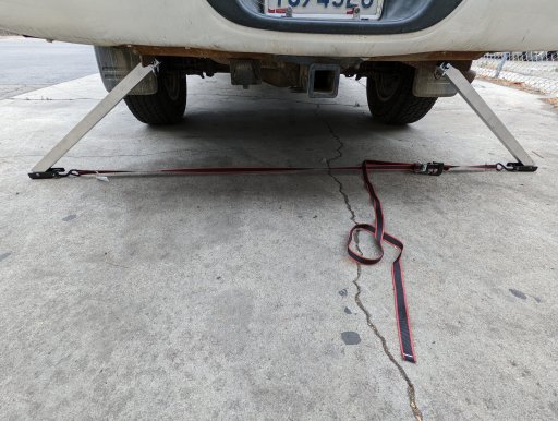

I started with a 500 lbs ratchet strap but with the angles and my weight moving around, I upgraded to a 3000 lbs ratchet strap.
Quick project but makes sleeping a lot more enjoyable...
