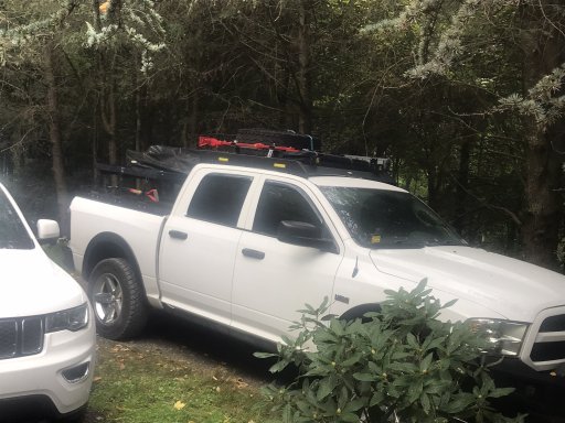

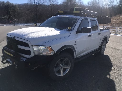

My truck was started its life as a work truck so it already had a Adarac Truck Bed Rack. I then got 6 (really only need 4) Dinoot No Weld Trailer and Truck Rack Crossbars and got some 12g Unistrut for the cross members. If you do not want to get a Adarac rack you can look at the Dinoot No Weld Pickup Truck Bed Base Brackets. I used the Adarac so I can still use a Roll up cover with the tent mounted.
Please see Charles Pages Video on how he put his version of the rack together on a RAM 2500. Mine is on a 1500 with the 5.7 bed.
Note: I have extra room on the passenger side of the rack so I added a trailer hitch cargo carrier which I had.
Why?
1. make it easier to work with the tent.
2. hold the diesel heater
3. make it easier to get the spare tire ( and everything else) off the roof.
4. hold cooler and wood.
4. fill up the space ( This is really the reason! The others came later after I realized what I could do with it)
This system has been working since 2019 and has taken a number of hard hits without a problem.
If you have any questions please let me know and I will help in any way I can.
