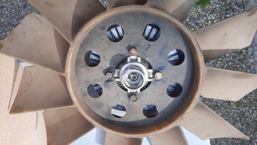

Again, the visco coupling of the fan didnt work at least not below 101 celsius. Which should start working at 95 C.
So, took it out and drilled it through, bolt through it and now it should work all the time.
Tomorrow a testrun with it.
Hopefully monday or tuesday the new thermostat is coming in.
I already ordered a new Visco.

Did the testdrive today.
Conclusion its the visco coupling of the Fan.
I ordered a new one.
So, I still will replace the old thermostat and will flush the whole cooling system. Then new coolant in it.
The fixated visco coupling will get a permanent place in the car with the special tool/wrench I have to use to loosen that thing.
I have ordered an infrared thermometer so I can really check the flow of the coolant with heat differences. ( knowing through testing and measurement instead of gambling)
I will order an OBD2 display plus sensor and through that I will be able to have a better read out wath really is going on in the car.
For now my bluetooth OBD2 sensor and smartphone will do the trick.
I hope that coupling will arrive this week. As I need the car next saturday.
Then if all is installed the last testdrive again.
