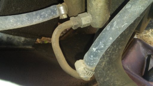

So here are pictures of my fuel lines. You can see the tight bends it is performing when is exits the frame and heads to the fuel pump.
Is there a reason behind the bends?
Fourth one is the rubber house between the fuel pump and the hard line going into the Carb. This I was wanting to either hard line or reconfigure it some other way, don't really know yet.
I don't have any fuel delivery issues I was just wanting to simplify somethings and possibly upgrade the durability of some components

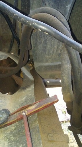

The last one, while we are talking about hoses, is my power steering pump hoses. Why do they bend up like this? Should I reroute them when I go to replace them? Would upgrading to a stronger rubber or silicone hose here deliver a benefit?
