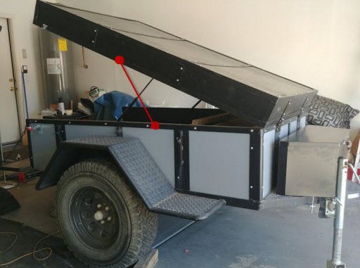

I used some 4" hinges from Home Depot for the lid. They seem to have shifted and allowed to lid to move forward so I am looking to upgrade. Thinking weld on hinges. Right now I am looking at the two options below. Please let me know what you think or if you would go a different route.
Trailer for reference.
First option are these hinges on amazon. Look pretty good. Not sure if there is an up side or down, but seem beefy enough. Would be able to mount about the same place I have the hinges now. Like that I could remove the lid if needed it seems.

I'll bet if you changed the direction of your struts you might eliminate the tendency of the lid's weight to be on the hinges.
The way you have them now, when the lid is open, the struts aren't working in your favor, they're actually pushing the weight of the lid onto the hinges.
With the struts facing forward, in other words pushing the lid to the rear of the trailer, they will actually be helping to keep the weight of the lid off the hinges.

You know, that makes a lot of sense. I set those up pretty quick with no instructions or reference in 110 weather.
They are 100lb each, 20o total. Would I just take the side on the trailer in the front and put it on the trailer and flip the rear to the lid side??

Not sure what you mean, but what you want to do is change the way the force is acting on the lid, right?
So you would probably change the pivot points if you're happy with how those lift the lid... are they strong enough, does the open lid bounce up and down on a windy day, that kind of thing.
You'd want to work out the geometry to make sure your extended and compressed lengths work out, and you lift your lid high enough for you, but basically this idea.
