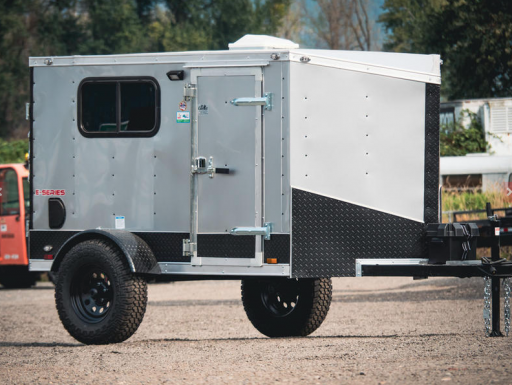

My wife and I are looking for an "off road" trailer (more for rough fire roads than actual hardcore off road), and we saw a 5x8 enclosed trailer this afternoon. The trailer manufacturer "upgraded" (or downgraded) from a leaf spring axle to a 3500 lbs torsion axle.
We are planning on converting it into a small overland trailer.
What are your thoughts on how the torsion axle will perform on fire roads?
Thank you for your time.

its pretty much like everything else where there are articles and research claiming good and articles and research claiming bad.
i bought a 16' enclosed trailer nearly 20 yrs ago for my construction company at the time. the company is gone, but the trailer is still here and it's torsion axels have hauled a lot of stuff all over jobsites. zero problems. i also have a tear-drop type camper with torsion axels and it has bounced around at big bend and rough roads all over. zero problems.
i think repairs would be harder on them out in the field, though. the military uses the dexter torsion axels on their trailers, so there's that
i know this isn't part of your question, but have you looked at Timbren axel-less? might also be worth a look
fire roads aren't that crazy bad, so i would say that the torsion axels would do quite well based on my usage of them

I've never had a problem with a Dexter torsion axle.
I'm having a 3500lb one built on my new off road teardrop that should be done in 3 weeks.
