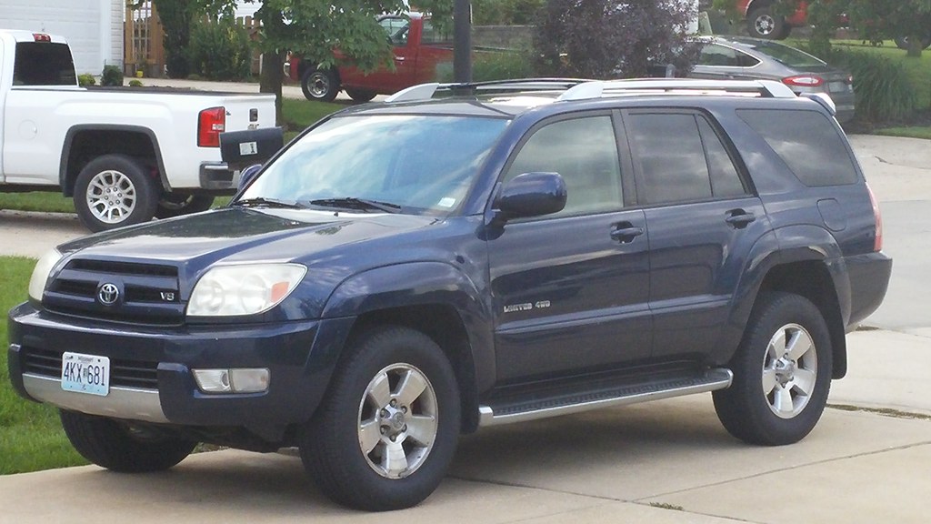

I had been searching for a Tacoma or 4Runner for a while, and finally decided a 4Runner would be a better choice. Finally found a 2004 T4R Limited V8 about 3 hours away in Champaign, Il. Went with a few friends and checked it out and ended up going home with it June 13th, 2015. Has a few cosmetic issues, but nothing major. I figured if I'm going to off road it I shouldn't be too worried about the outside appearance. It just has to be mechanically sound. It has a few scratches the buffing won't take out, and the front bumper is cracked, but that's it. Everything else is pretty much perfect.
Day it actually became mine (Got plates)
0626151911 by Thomas Horner, on Flickr

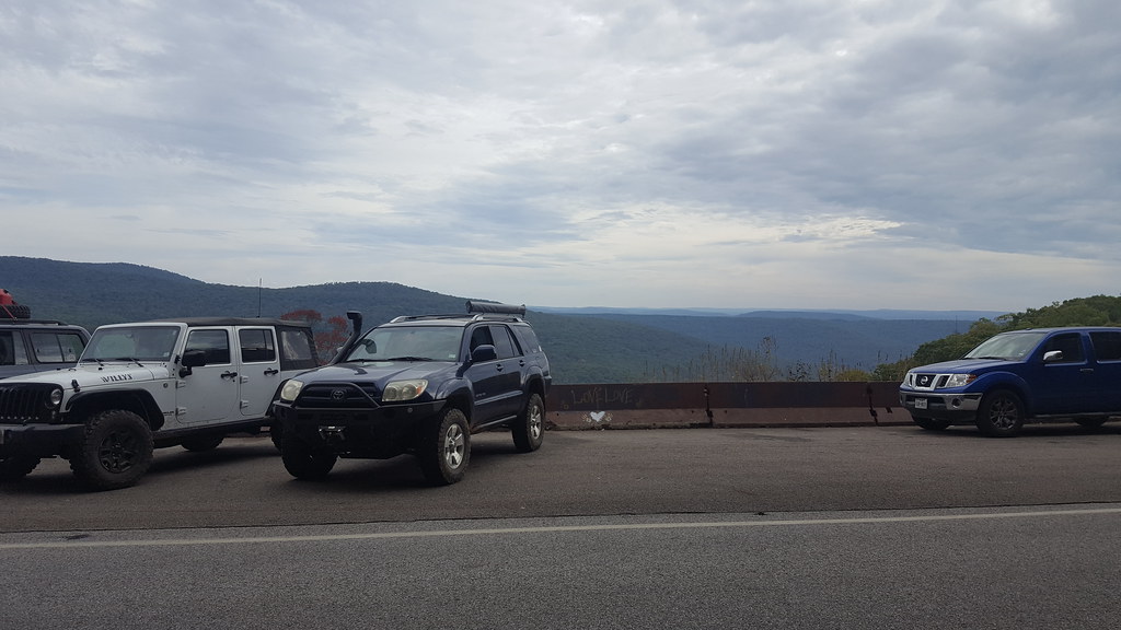

At the end of October I went to Rendezvous in the Ozarks in Arkansas with a few local MO4WD members, and met up with some Tornado Alley Land Cruiser members. That was a pretty good weekend even if the 4runner was making some uncomfortable noises for me to push it off road too much.
20171020_115901 by Thomas Horner, on Flickr
20171020_102924 by Thomas Horner, on Flickr
20171020_102004 by Thomas Horner, on Flickr
20171020_105139 by Thomas Horner, on Flickr
20171020_115518 by Thomas Horner, on Flickr
20171020_115548 by Thomas Horner, on Flickr

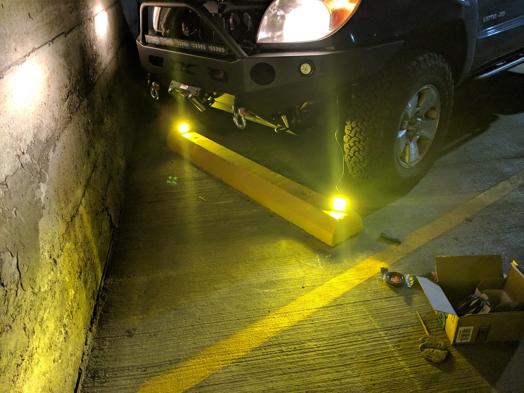

I was hanging out at a friend of mine's booth while I was down there and got talked into a 30" Diode Dynamic light bar. I wasn't planning on buying it that soon, but we were talking about it, then we tested fitted it, then next thing I know we're finding a drill to mount the thing to my bumper. It all happened to fast :laugh:. It looks good and fits perfect though. This is basically where it sits for not. I still need to wire the light bar to an actual switch, and not the cheap one it comes with. I still need to wire the winch to a switch too.
20171113_145301 by Thomas Horner, on Flickr
Edit:
Forgot I also picked up some LED fogs from Amazon too. Once I do the fog light mod I'll get some pictures of the fogs actually on the rig.
MVIMG_20171118_160107 by Thomas Horner, on Flickr
