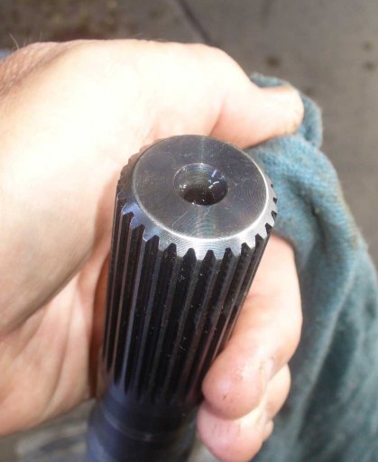

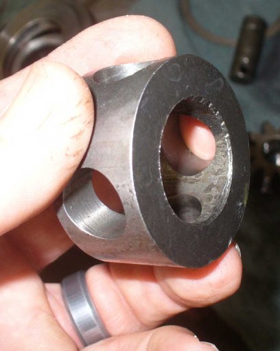

A couple of years ago I had a shop tear into my front axle in pursuit of a noise that I couldn't track down myself. They did indeed find it, all the way in the center of my ARB carrier. And the only way to find it was to tear the carrier down. It didn't show at all on the axle.
This is what was happening inside the carrier:
And this was what the end of the axle looked like:

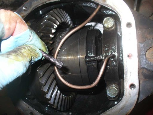

I wasn't going to have found that on my own. The shop did find it. And this is not the only job for which I have used that particular shop, and I would use them again if I needed to. Even after finding this today, on that very carrier they disassembled:
Evidently they didn't get those bolts properly reinstalled. My guess is that they damaged two of the retainers (you can just barely make out one of the retainers at the top of the carrier) and didn't want to hold up the job in order to wait for special order parts to come in. Those retainers might even be a single use item.
Point is, a shop isn't going to stop and present a customer with the choice to wait for parts or not. Among other things, the shop wants that lift cleared out so they can get to the next vehicle in line. They have other customers and a profit motive which are not necessarily driving the same priorities that matter to me. Now, two years later, I get to wait for special order parts. And hope that my bearings are not going to suffer from all the glitter that has been circulating in them.
On the bright side, I found this problem at home, doing my own routine maintenance, and not on the trail with a disaster on my hands. The outcome of the shop's decision could have been much worse.

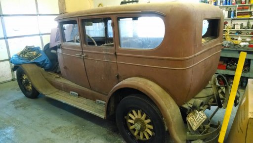

I too made a lot of money from “Those Shops”. My lift was known to house rigs for months at a time, one bay had a customer’s 1930’s REO for nearly 2 years as we waited for the engine to turn one full revolution so we could make it a runner.
And, no we would give the customer the choice to get parts and wait or try to come up with another solution.

Looks like you're gonna have to straighten that spare wheel out a little...
The owner of the car had found a spare wheel, along with a hole lot of other parts...
Sad story to this car: the owner was a long time friend to my dad, and installed garage doors. He literally found the car in a barn he was installing doors on back in the 80’s. Every time he had to go to the area he would stop in and try to by the car. Nearly 30 years later he was finally able to buy it. We had the car 2 years trying to get the seized engine to turn over. Finally one day the engine budged and about 2 weeks after that we were able to get the engine running. The owner then took the car back to his house to finish the restore. 6 months later his wife died. Then he got very sick and put into a nursing home. His daughter sold the car to a guy who chopped it up for one of those rat rods.
