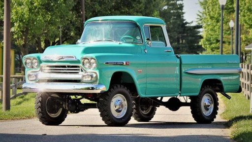

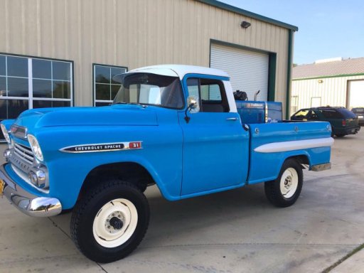

I'm not old school at all, (BS) but these were capable off road trucks and the tire size was not that big a deal. Remember if you go 3" in tire diameter it's only a 1.5" in height difference.
I think Tacoma's get overbuilt. I know this because I'm a TW reject. LOL Tacoma's are very very capable trucks. I'd beef up the side wall, tread pattern and call it good with the suspension enhancements.

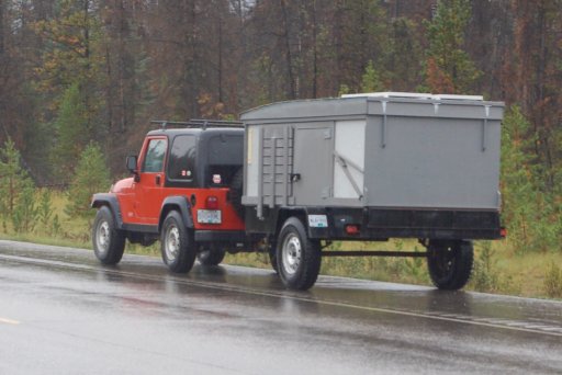

Bigger tires do not make you more capable unless you need floatation, ie, deep soft sand and beaches.
The negatives of bigger tires, they are heavier, you will get a rougher ride, increasing unsprung weight is a guarantee handling will be worse, ride will be rougher, other things will break. And heavier tires not only accelerate slower, they decelerate slower too. Expect longer panic stopping distance. Expect more often brake jobs.

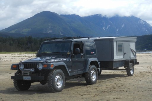

I've done 35s on an LJ with a 4" lift. There were no advantages to 35s wheeling on FSR, logging trail spurs, accessing waterfront camping spots. Thar was 15 years ago. Since then I have been going smaller, staying stock with suspension and driveline. And loving the smoother ride and better tracking thru sand and snow.
One thing we ignore as we up size tires and lift is gas mileage. I too was guilty of this, no way was I going to say going to 33s, 35s was a mistake however now that I am running skinny tires the gas mileage improvement is outstanding. Going from 33/10.50R15s to 7.50R16s.... technically 185/100R16s.... I gained 5mpg, from 17mpg to 22mpg. The big benefit for overlanding is with a 19gallon gas thank, 5mpg adds 95 miles to my range.
I know I'll get slagged for saying it but if you are overlanding bigger tires are counter productive. Bigger tires are not more secure. In fact on any hard surface where you don't need floatation, a skinny tire is more stable and secure.
Winter driving is where pizza cutters rule. I can pull thru the pile of slush on the centerline and pass at will in the winter and spring. Guys in Quadcab diesel pickups with tires sticking past the fenders try to follow but they always chicken out. Thru rain, standing water, slush on loose gravel, catching a soft muddy spot with the right front tire.... the last thing you want is floatation.
Stick with skinny tires, big rubber is all hype and ego. Skinny rubber worked wonderfully 60 years ago and it still does today. Instead of jumping up a size, jump down in width and up in profile. You have 265/70s.... get 255/85s..... you'll get a skinnier but taller tire. I ran 255/80R17s on my TJR... but I prefer the 185/100R16s today.
Then there is tire life... None of the LT tires I ran, KOs MTs DTs, mostly 33s lasted more than 75K KMs... These skinny 185/100R16s go 100K KMs easy.
And with the same tires on the trailer. I'm a fan of the retro old school look way more than a guy wanting to blend in. I made my choice of 35s on my LJ because I thought they would improve capability, in fact they made it obvious I was going the wrong direction.
Then theses guys running skinny tires forever, not many rigs on this forum would want to follow them, a few would yes, but these guys do it with tiny tires.
Must be a reason and I doubt it has to do with budget.

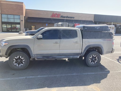

I have a 2020 Tacoma TRD OR.
Something to think about, your stock tires are so light because they are made with small thread depth, 11/32 new9k miles. I went to Cooper ST Maxx “E” rated in a 265/75/16, a 32” tall tire at 54lbs. I had thought about going to 255/85/16, but didn’t know how the truck gearing could handle a 33” tire, wish I had. I replace the suspension with Ironman Foam Cell 3” lift (no sure how much weight add, guessing 200-300 lbs, this suspension is so much better than a stock one), added full aluminum skid plates, a Victory half rack (75 lbs) and a TuffStuff Alpha ll RTT (140lbs), a Dometic 75 fridge/freezer, added a Victory front bumper insert and Warn Zeon 10s winch and some other small stuff for a total of 600lbs increase. I know the weight, because I went to a truck scale before and after, watching the weight I am adding. I am building this for overlanding and long trips.
Be careful of going too large a tire unless you plan to rear gear. I don’t about this personally, but from what I read this truck doesn’t like it.
So with the above information, the truck rides great, doesn’t sag in the rear anymore, still has about the same power, better after a tune and fuel mileage dropped just a little, maybe 1-2mpg, thinking closer to 1. If I get above 65 -70mph or so, it really drops off, but it did that before too.
