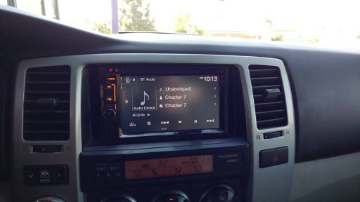

Looks good bro. Not a lot of us 4gen owners out there! What audio system did you put in to replace the OEM radio?

Dang might be hitting you up for tips on that. Pretty easy install? Did you have to by a camera with it?
If your model comes stock with the factory camera, then you use a transistor that bucks the 12 volts down to 6 volts for the Toyota camera. Then you splice the video data line and ground from the factory wire harness to an aux video cable and plug it into the back of the head unit.

I'm actually thinking about switching to an Android auto unit and running the USB c cable to little tray where the outlet is by the gear shift. So we'll see how long that unit stays in there.

Ya mine came just bare bones. So I'd have to install a camera. Android auto unit hun have to look into it.
