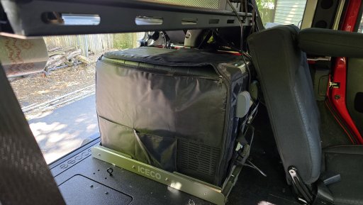

I've been running an Iceco JP-40 since 2020, and with the fridge slide now installed in my 2022 Jeep JL, I've been keeping it powered on in the back 24/7 now. The other day I was packing for a weekend trip. Wanting to leave home at oh-dark-thirty I packed all my food and camping gear in the Jeep the night before. I came out to a fridge failure and my perishable food spoiled with the internal temp at 62° for five hours previous. The DC circuitry seemed to be the problem. The power cable was good and the connections were clean but the DC power would shut down after a few minutes. I moved the power over to 120 from my Bluetti inverter and got through the weekend but it's horribly inefficient power-wise, and I have to recharge the 1440Wh Bluetti every two days now. I no longer trust the Iceco fridge and I need to replace it ASAP with a high-end unit.
I don't trust Iceco after this, so that essentially leaves ARB, Dometic, Engel, or SnowMaster, and I'm leaning towards ARB for its reliability and energy efficiency, but I'm open to opinions. Money isn't a factor, but space, reliability, and remote monitoring is. I have the Goose Gear plate system in the back, and whatever fridge I buy will have to fit on it, behind the left side 40% back seat.

Yes, I've heard the same thing which is why it's on my list. Size is my only concern. Will it fit behind the back-left seat in a Jeep JL? Whatever fridge I purchase must fit back there, period. I run a ground tent/cot setup and the space to the right of the fridge is required for the rest of my gear.

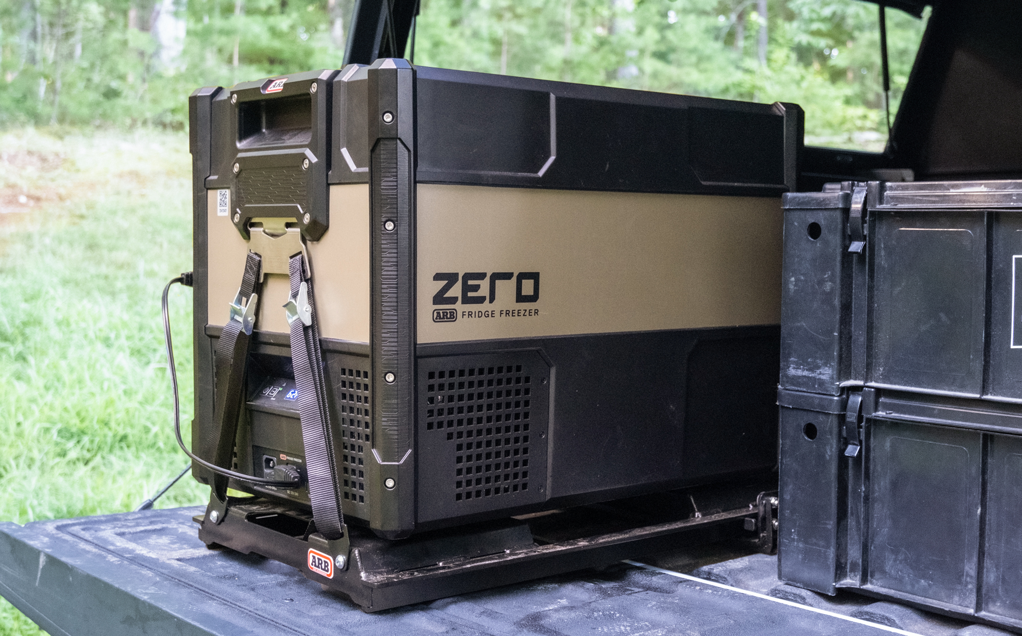

The instructions for both will say minimum clearance of 2" on all sides. I have that but on super hot days, it can struggle to keep temps lower than 42 degrees. (Mine is also a 63qt, so probably works a bit harder than the 50 qt which has the same compressor). Really, the fridge just needs maximum clearance around the compressor/condenser which is where all the vent holes are in the pic. For me, there is ample airflow towards the rear of the vehicle, less behind the 2nd row seats.
(Not mine. Just random pic of ARB Zero)
NJRadioGuy
Yes, the Iceco has the 2" rule as well. I have the slide positioned so it gets 2" on the left side, and I try to put things around the right side that leave as big a gap as possible. Now I see what you mean by the compressor location being an issue. I would definitely prefer it to be at the back!
