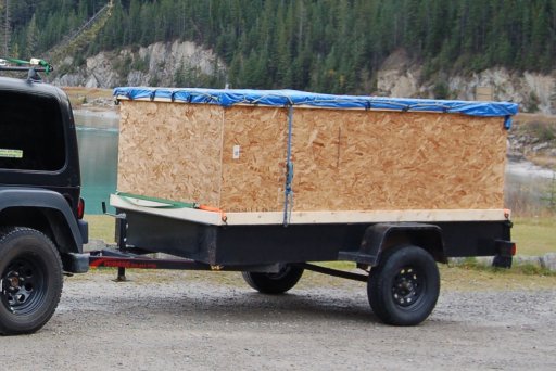

There have been a few questions about the rims on my TJR, they are a generic, no name brand, for winter tires.
Here is the label off the box. This all there is to identify them.
