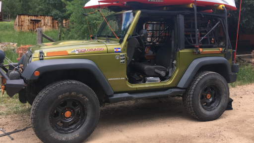

Chose the JK because I love the off-road capability and taking the top and doors off. I am much more of an overlander than a rock crawler and have been building my JK with that in mind. With my current setup on A/Ts it cruises at 75 mph and handles some gnarley trails.
Current equipment:
2010 JK Mountain Edition
3.73s
2.5” aev lift and 315s
12k lb winch
KC daylighters
Premium soft top
Bestop rear bumper and tire carrier
Barricade front bumper
Hi Lift jack
Quick release sway bar disconnects
A bunch of extra underbody protection
Viar 300p air compressor
Bestop overhead rack
Future mods:
Regear, likely to 4.56 or 4.88 for added OD use and not to kill cruising RPM
Better cooler that’ll fit behind the back seat
Alternate power—since I use my laptop to work while on the road. I’ll most likely go with a dual battery setup.

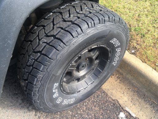

Finally bought new tires. I went with Big O Big Foot A/Ts. Here’s why:
These are some of the lightest LT315/70r17s out there at 60.3lbs which is good as long as I’m running a D30 up front and 3.73 gears. These tires are made by Cooper and have similar tread as the AT3 which have good reviews for AT traction. At 17/32 they are chunkier than KO2s (15/32) but are by no means a MT. Winter rated and lots of siping. D load range (a lot of 315s are Es and I feel that’s unnecessary for my lightweight Jeep). Price was right. Only LT315 I know of with a 60k mile warranty. And they say Big Foot on ‘em which is fun.

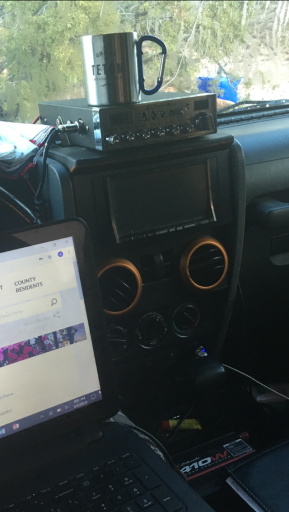

Anyways, I've since upgraded my CB from a handheld to a semi-permanently mounted set-up. It clears up space in the glove box and keeps me from having to dig around for the antenna cable every time I want to hook it up. I have also been using my Jeep as a mobile office more frequently. I have a 410W adapter that I currently run from the cigarette lighter, but I am planning to permanently mount it somewhere and hardwire it to the battery. Part of the problem is I'm running out of space to mount things in the interior.
