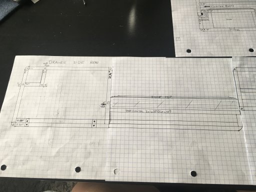

D32971BC-B683-4DD7-B7E6-8785D378A965.png Plans for the new one

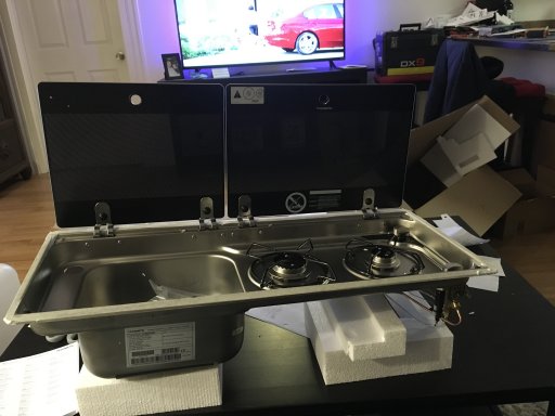

New sink burner combo purchased on eBay from England. These things are everywhere in Europe but not here?

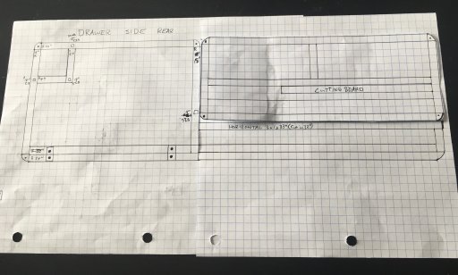

To make the plan more clear, the whole drawer slides out on 56 inch sliders. Then the upper section slides out to reveal the cooktop 35CB15F6-1428-4DA9-B0FC-F52150A1819E.jpeg6C8FB6C8-FD8D-4275-95A0-B0A90C40AEF5.jpeg
The whole drawer with coffee table lift tops for more flat surface 8303F5C8-2C85-4619-82FE-7E8D1D428BC3.jpeg

Just received my Dometic 9722 that I bought off eBay from England. Looks really nice! Waiting on my 80/20 order to arrive. Honestly I can’t believe how fast it came, less than a week to get to California.8853488533
This unit comes with a Comet faucet that turns on the pump when you lift the handle for the water

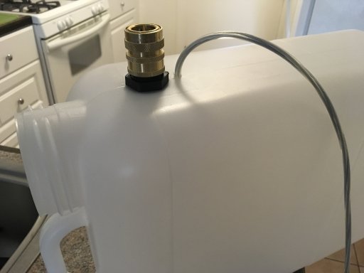

Step up my water tank and pump
Standard hose quick release

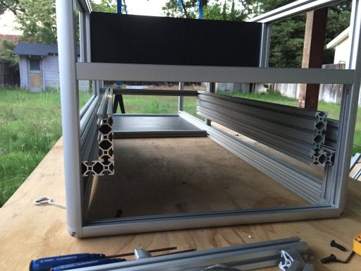

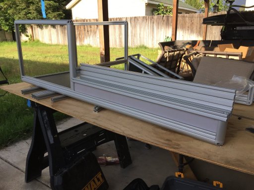

I finally got some more done on this project and some of the hard parts as I have rounded sections meeting square bars. I painted one panel in gray and decided it doesn’t pop enough, if I’m going to spend all this time and money it’s gotta look good to me :)
The frame is coming together. I did 1/4” HDPE panels for the bottom for strength, but as they are heavy I’m doing 1/4” light ply on the sides to save weight.
F3697A58-A8A3-4679-9AFC-2E0CE53771FF.jpegEBF83D6A-A8B6-4369-BB4F-B828F057061E.jpegF93C03A5-487C-41BE-9AD8-48B85E777D6A.jpeg

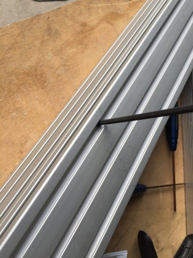

This cut took awhile to make the initial pass then I used a dremel to shave it more precisely, I’ll clean and polish the aluminum when it’s done
80/20 doesn’t have all the connectors I need for the type of joining I am doing for this build, so I’ve had to come up with some backyard solutions.
Notched to fit the head
Lengthwise connectors, I used T slots nuts that are tightened through access holes
For this build I am using rounded Tri-connectors, hidden corner brackets, T nuts through access holes, and more notching
Here is the drawer set up in it’s closed position, nothing is attacted just placed in position
Slightly extended position, but my work table is bowing so it doesnt line up right
End shot which shows the “channels” that the locking sliders for the top section will be mounted to
Making progress!

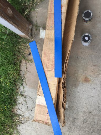

I got more work done today but it was a little slow because I am cutting panels to fit, then painting and waiting for them to dry. I have my blueprints but figuring out as I go along how to assemble it in proper order, kind of reminds me of an IKEA dresser. :laughing:
I changed to the blue but not sure if I’m gonna stick with it, the panels are easy enough to pull out and repaint if need be.
BLUE!
