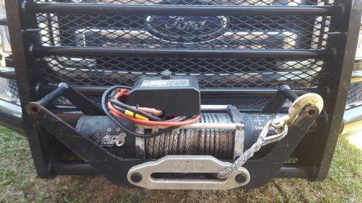

I have the cheap tractor supply goods.
But the winch is in my toolbox unless it's in use so it will last fine for me.... we will see
