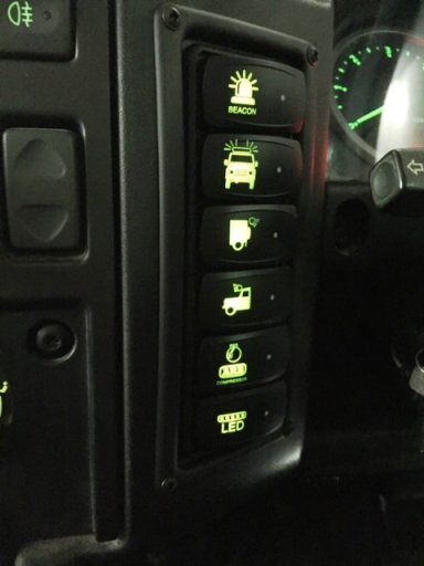

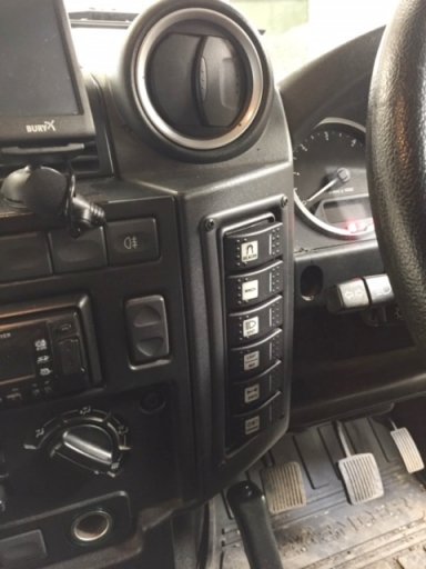

I've been recently re-wiring the Raptor Dash that someone had put into the D90 I am using,
Completely messy wiring so I've stripped it out and im making my own loom (atleast its not all the same colour!)
The ones on this one are "RDX" switches, I must admit, they do look and feel pretty good quality
There is a Seller on eBAy in UK - "Bolt-On-Bits" their not the cheapest in the world but they certainly seem pretty good to me
considering previous owner who had the switches in this defender was a farmer...

I am in the process of fitting a switch panel to my 90 dashboard. I have bought the bits from www.mudstuff.co.uk below I have attached pictures from their website to show the sort of thing I'll be doing.
The switches I'll be fitting will be for: Light Bar, Rear Work Lights, Air Compressor, Possibly Front and Rear Air Lockers, and a Double USB Socket.
I have never used Carling Switches before so It may not go well. I need to identify the Sidelight wiring in order that the switches will illuminate as required.
