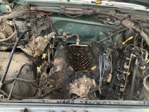

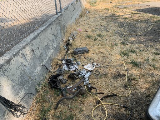

As for doing the work in the driveway... we do what need to be done.2116FEE3-1D17-4733-89BF-12E3AF1E5C23.jpeg1B564DFA-5F16-4D0B-8165-35E20D45C46A.jpeg4F6A723C-88B1-4A4C-882C-DD3DB501E801.jpeg

As for doing the work in the driveway... we do what need to be done.View attachment 188201View attachment 188202View attachment 188203
I have no room to complain then. LOL. As for the "long winters" and the "frigid cold" we have actually been warmer here almost all winter than most of the central states. Remember, we are in SE AK which is maritime climate or a little cooler than Seattle. It has been referred to as "Seattle on Steroids" (referring to the amount of rain, of course).
