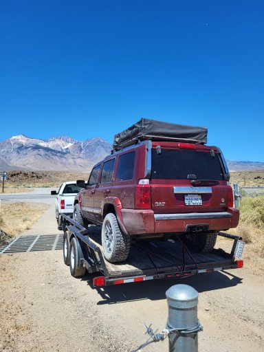

5.7 hemi terminally wounded.
After some investigation, I found no compression in 6 of 8 cylinders.
Cylinder #1 valve seat flopping around on the valve. Valve made contact with the piston. On the bright side, my oldest son is going to take over the jeep, and I will start another project (fullsize)
